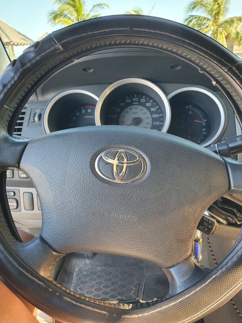

    Has anyone added steering wheel controls on 2nd gen Tacoma, mine is a 2007 without steering wheel controls, would like to do an upgrade. I have a Dasaita head unit installed

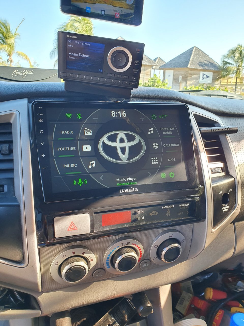

    To much stuff on that windshield. Blocks view and must be a huge distraction when driving.

    Was laid back having coffee by the beach, doesn’t block my view whilst driving.
    This is in the carribean islands

    Still to much blocking the view . Have been to the various Caribbean Islands and it still would cause a possible problem for me.

    It's my sirius xm radio and dash cam, planning to relocate xm radio

    Glad you plan to move the radio. Where I am used to driving there's a lot of animals that can pop out and you need complete visibility. Also erratic drivers and cyclists. I know you feel fine with it, and all the power to you, but it does increase the risk of a collision. I don't like my wife's Chevy just because the pillars are thick and have hidden many vehicles I should have been able to see.

    So I opened up the steering wheel shroud this morning,it only have 3 wires connected to the clock spring,but there are wires leading to the he. The three that are connected is for the cruise control. I have a steering wheel and airbag for a 2014 Corolla coming in by next week, will have to check if the Corolla clock spring is compatible. Will update once I get it.

    Steering wheel upgrade update- Finally got the steering wheel and airbag, unfortunately I will have to replace clock spring cause mine doesn’t have pins for swc, ordered one already.
    Radio was a direct fit no trimming.
