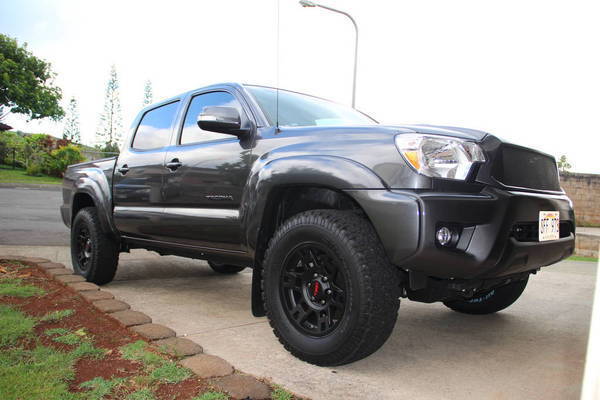

    BTW Op, really like those TRD accessory wheels you have on the truck, any pics of the entire truck with the wheels on it?

    Nice, that combo looks just right.
