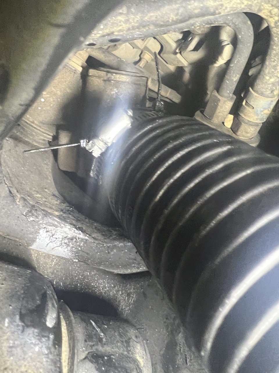

    19A70640-8F9E-4532-8FC2-4F9CD876EBDE.jpg 0B9D38AC-2CAE-4F4F-A725-188DB1F2899B.jpg FDD9F3FC-86D0-4561-A622-80E6A61696BA.jpg
    Added hose clamp while wait for new boots to arrive
    E7AE51AD-4006-4A70-B867-0E8CD669531E.jpg For now I’ve managed to get a hose clamp tightened on the rubber boot until the ordered parts show up. Also I’ve added a few more pics in case y’all spot anything else for me to check. Thanks for the help everybody
