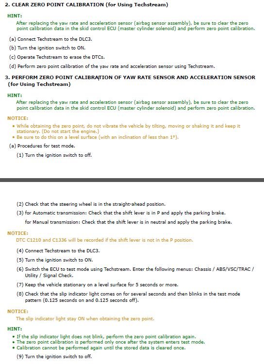

    Around 2019/2020 the paper clip jumper method for zero point calibration was no longer enabled. What codes are you actually getting?
    Technically, the steering sensor zeroes itself every time the truck is started and driven. The issue after an alignment lies with the "new" steering angle zero value varying vastly from the previous values or not jiving with the yaw/accel sensor signals. You need to do a zero point calibration on the yaw rate and acceleration sensor to correct. When you do this procedure you first clear zero point calibration data (this will include the steering angle sensor) and then you perform the zero point calibration of the yaw and accel sensors.
    Techstream is how I know to do it with trucks that don't have the jumper method available. Attached is a snippet of the techstream procedure. For other devices you will be looking for something like this.

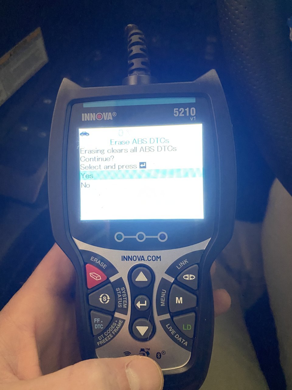

    Bought the Innova 5210 after reading this thread. Plugged it in, pressed system status, navigated to Abs, pressed enter, error codes displayed. I choose the erase all codes. Done; just that easy.
    IMO, $100 for the tool isn’t bad for what it does.

    I can vouch this works. I literally bought it on Amazon overnight and followed these exact instructions and were good.
    My issue was the following:
    2020 TRD Off Road 6 speed manual
    I had bent a steering knuckle aka spindle about an inch. My passenger side. So I opted to buy a new one and also snagged HD gussets from Fabzone. Welded them up after taking apart both sides and pulling sensors out bearing etc.
    After putting everything back together and getting aligned I had the same issue with the abs/ steering position sensor.
    here are some pics of the unit while using it this am
    note the collision sensor was still on so I turned truck off and back on. It’s gone. Thanks guys!!! Hope this helps more people in this situation. No dealer needed here.
