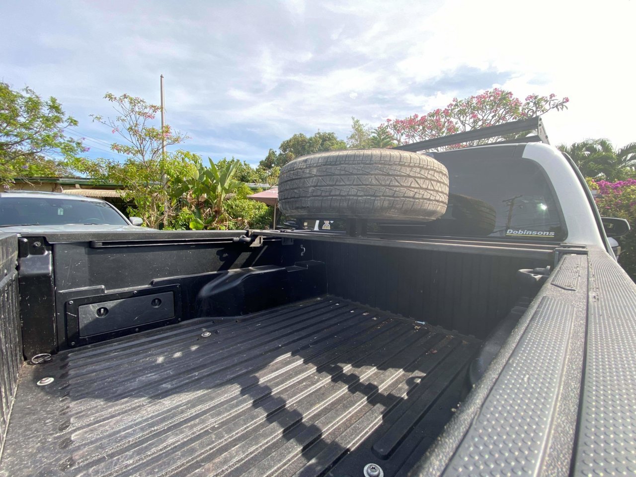

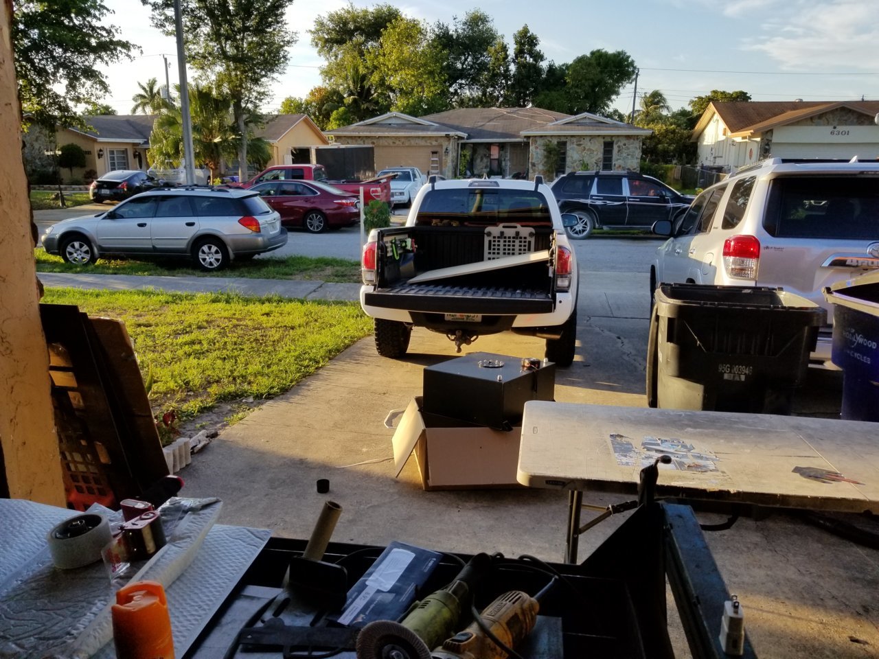

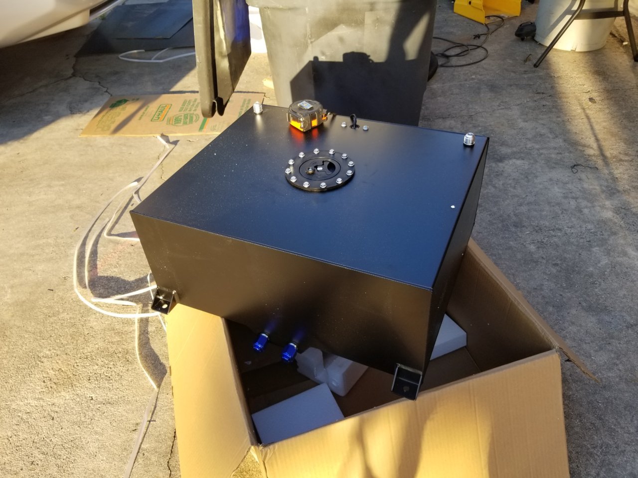

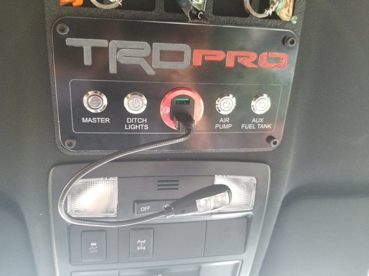

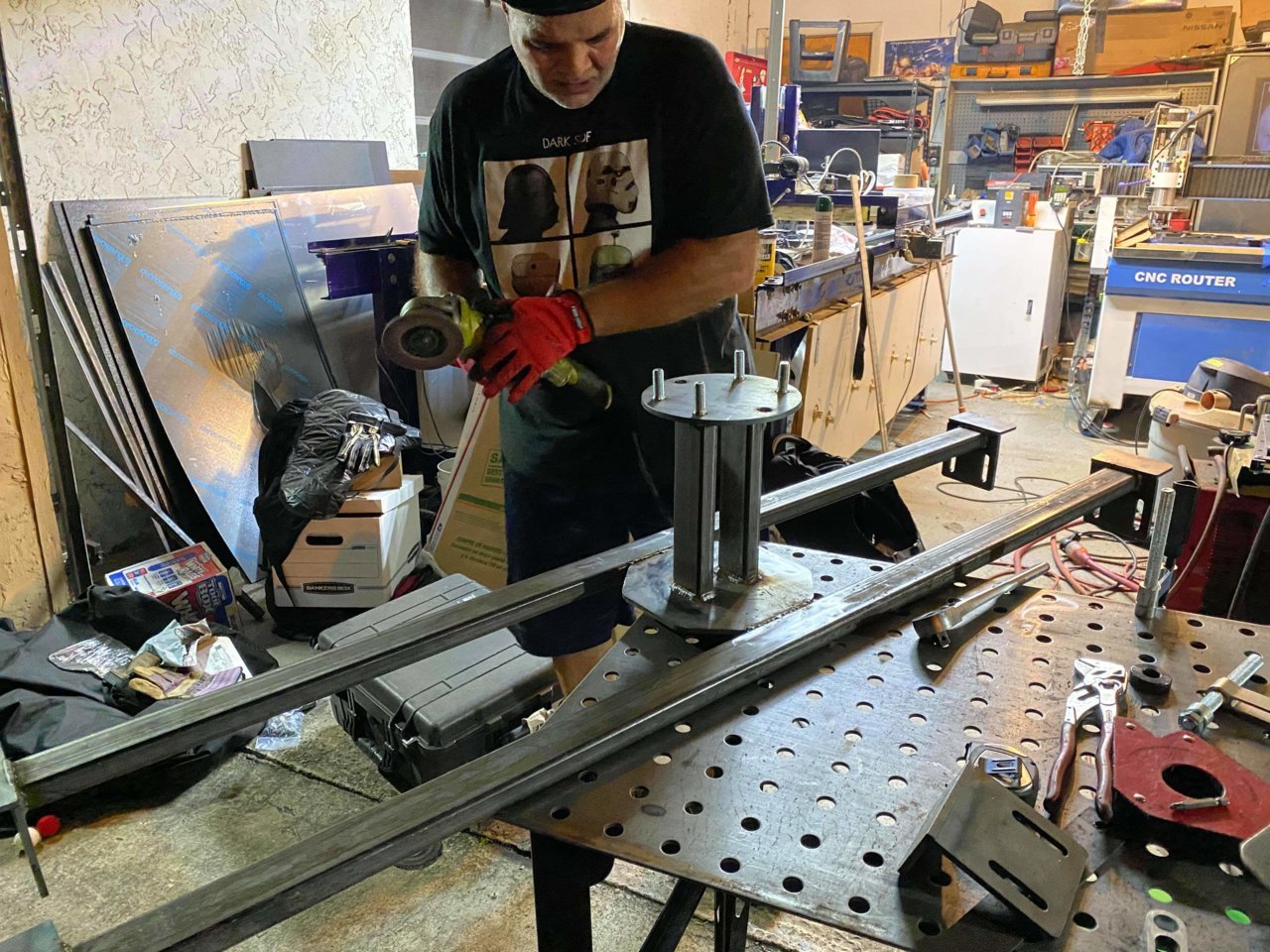

    Hurricane season is almost here. Two years ago it toom me 18 hrs to reach the georgia border. All the fuel stations were empty, luckily i had a bunch of tanks but it took way to much space. Im taking out the useless spare and putting a 20 gallon tank in its place. Ill be removing the whole tire crossbar and winch mechanism and will be welding up no stiffening cross bars and straps to secure the tank.

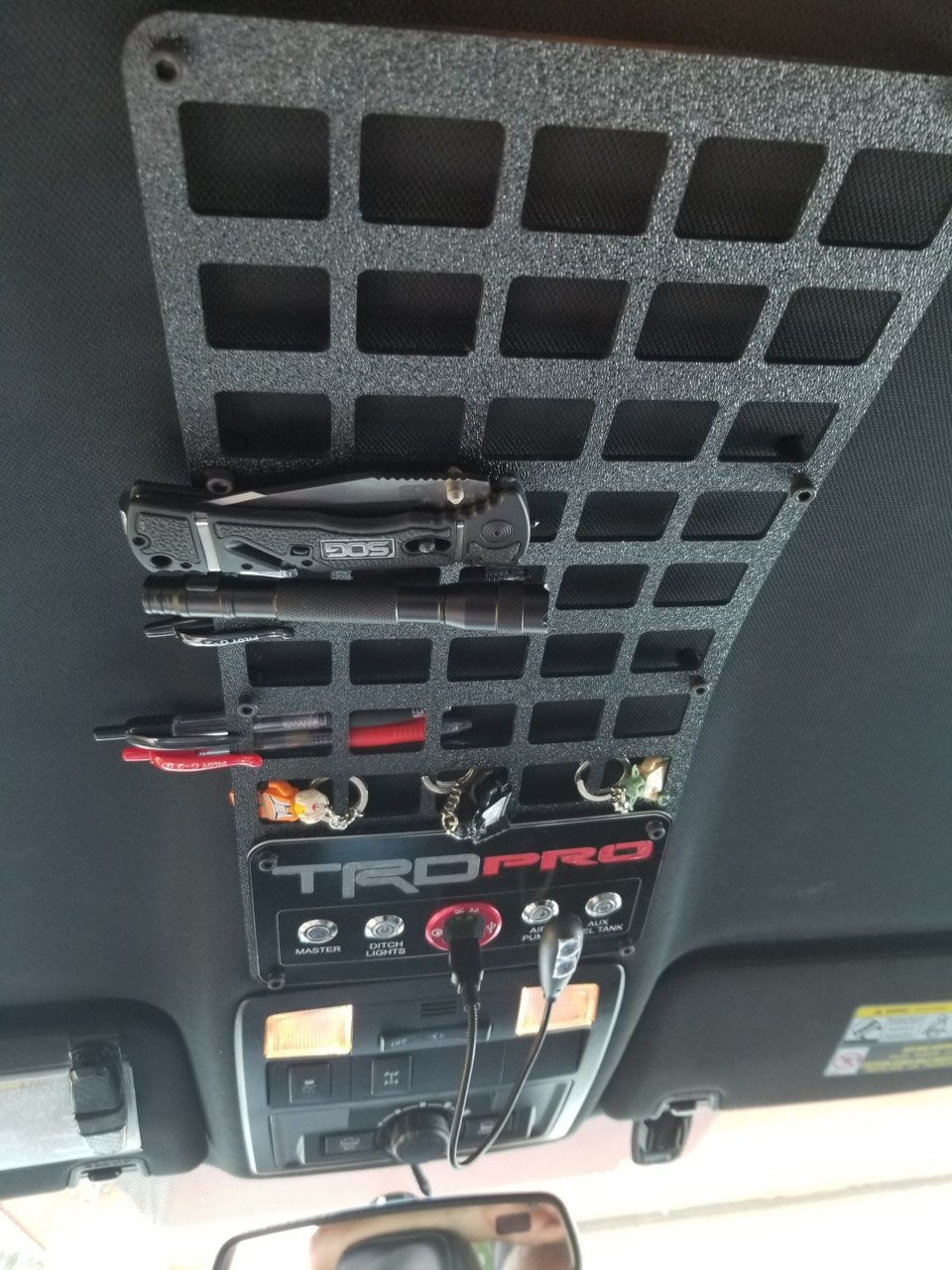

    Ill be making a fueling panel to replace the oem left storage box in the bed. There you will find the filler neck , system power, switch for fuel pump and a fuel gauge. There will be a master switch inside the cabin in my command center (right side switch).Ill be doubling the capacity by about 95%.. Lets see!

    I dont want to penetrate the factory tank for a return line and i dont want.to fill it up on the fly because i dont have a return line. Still in the works.

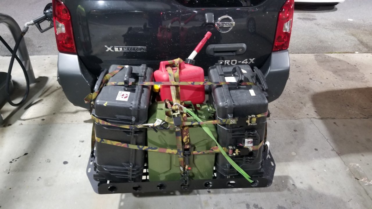

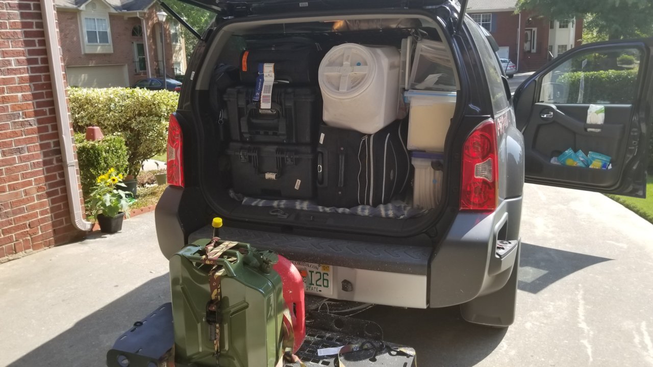

    No! Need all the space i can find. My xterra during the last major hurricane, add my three dogs to the mix :
