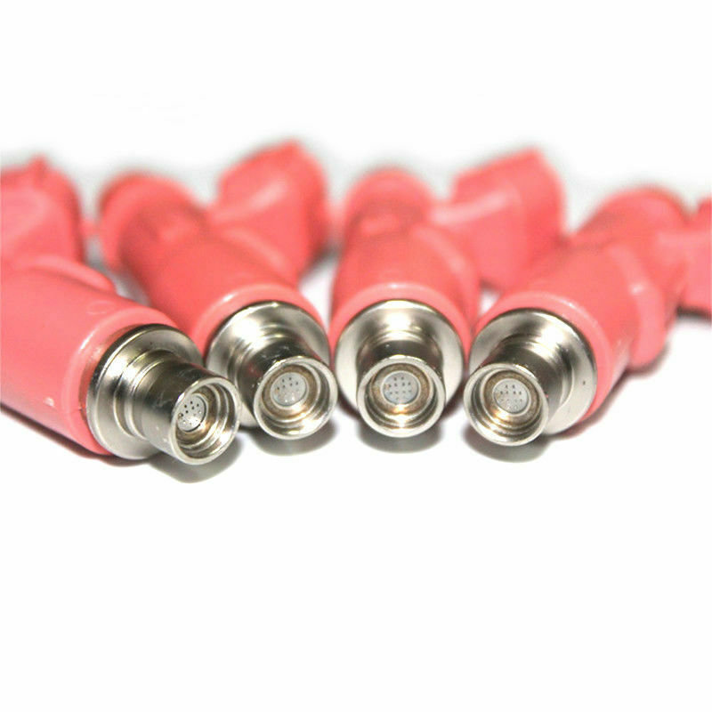

    Those denso injectors have tiny little holes and probably dont do well with fuel varnish clogging them up...
    And storing fuel for 6 months really degrades its quality....
    I would consider running fuel stabilizer and maybe even putting infuel injector cleaner ahead of time....
    and as little as possible gas left in tank...
    Kinda like a loaf of bread......come back and see what it looks like 6mos later.....
