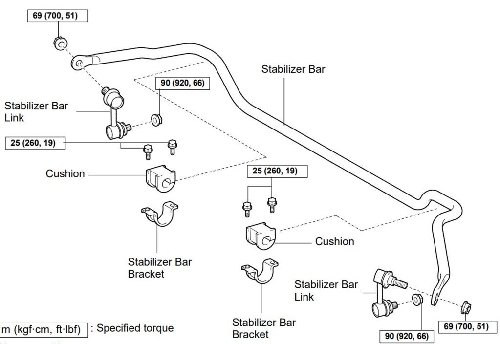

    FSM shows them facing toward the rear of the truck.

    Gotcha. Well thanks Andy I really appreciate that schematic. I wonder why there always has to be reputable sources with contradictory directions. I'd love to know the 'why' behind which direction the bushing should fit and what the difference is in the end.
    Thanks again!

    While the FSM is probably right- even it contradicts itself sometimes.
    As for the sway bar bushings- I really don't think it would make a difference... It's not going to fall off. It's captured by the bracket.

    Oh yeah.. duh.. it just occurred to me that the schematic you posted from the fsm.. is for and using the old style rubber bushings w those big wings on them.. which I can't even find online on rockauto,etc.. &they are all new space age super crazy poly material now.. so maybe Haynes takes that into consideration with their instruction of slit direction placement. ... ??? Who knows.. but it sux I don't have the time to sit on this site and ask everyone more questions.. I need to get dirty and ding a few knuckles b4 I even have the sway bar off. Lol! Good talkin!
