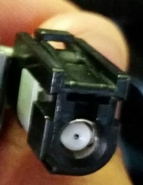

    I have been looking at that also. I have been trying to find a plug that will fit the radio and plug into an aftermarket XM antenna. Little cheaper than buying the new antenna and harness.

    That's the plug I need also. Where can I get one??

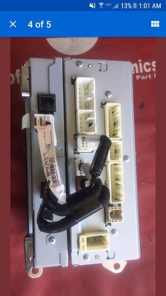

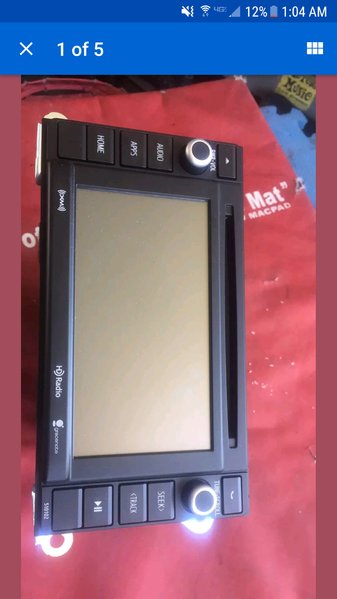

    The radio has the XM tuner. It came out of a 2017 SR5 .

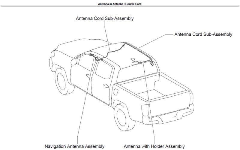

    Did anyone confirm that SR model trucks (Double Cabs) in particular come pre-wired from the Fin forward?
    I'd love to get an SR and just upgrade to an SR5 or TRD head unit and not have to worry about more wiring if it was already there.
