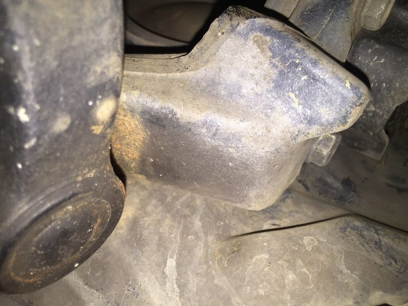

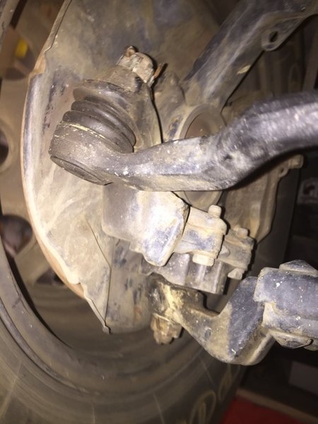

    This is a picture. Quite dirty, but it does look like it needs to be replaced. I cleaned it at car wash, and sprayed grease all around it and in it (as much as I could) and squeaking seemed to stop substantially. Assuming it is the ball joint, but I think I'll replace the lower ball joint and outer tie rod. Just the lower ball joint is bad, I believe.
    How would I check for grease, and what brand lower ball joint / outer tie rod is recommended?

    also. something does NOT look right in that picture. it looks like there was a shield/cover that came with your ball joint that was never removed on it's install.......... can i have more pics of that and the other side?

    What? I don't even know what it's supposed to look like honestly. It's currently cold and raining right now. Can't snap any more pictures, but I'll upload what I have of tie rod / ball joint. I really do believe the lower ball joint is going bad.
    These pictures kind of suck ball joint wise

    that rubber piece is a dust boot (if that's what you are referring to), transferred to my new LBJ when I replaced mine

    heres a pic of what its supposed to look like. yours has a wall around the rubber boot in the following pic. that just looks really weird to me. or at least it looks redundant. see following quote and answer..............
    but does it really serve a purpose covering the current boot on the LBJ? Ok. I see what its there for. its just acting as a shield so whatever kicks up doesnt hit the boot. its a separate piece that just bolts on using the current setup.
    so i know that boot isnt the issue.
