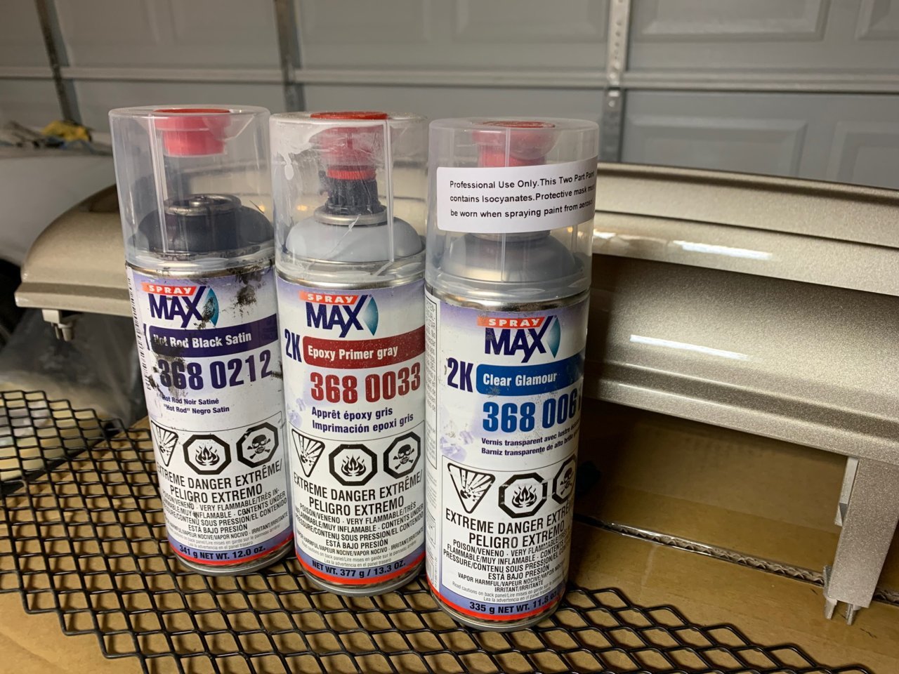

    Yep, wear proper ppe for this stuff!
    Perfect for small jobs and learning how to spray without proper gear. This was my first time painting and now i want to invest in a proper gun setup. Spray nozzles are 10/10 and no splatter like cheap spray cans. I love these Spraymax cans but they got really expensive for my project when i couldve just bought a decent gun.
    Paint matched jdm grill and front steel plate bumper. Straight out of the can there was minimal orange peel and laid super clear.

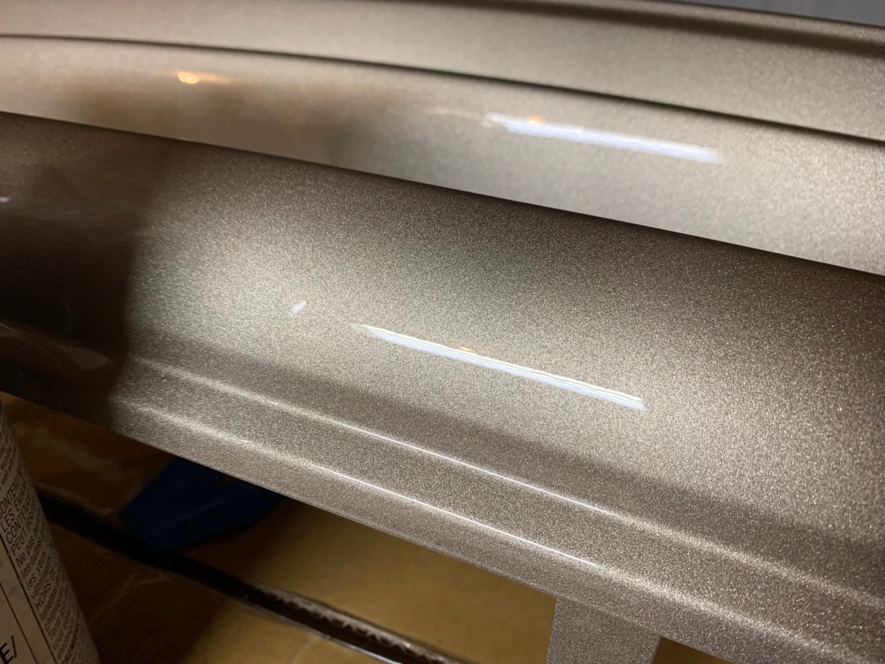

    Here’s a pic of the right front fender flare that I repainted and cleared with the Spraymax 2k Clear. I used rattle can paint from Automotive Touchup.com.
    Only worry I have is with how friggin shiny this is! After wet sanding, I’m hoping it’ll match up more with the weathered panels around it!!
    I repainted this a few days ago and used adhesion promoter before painting. That put a heavy texture down that wouldn’t sand out and looked like shit! I redid it today without the adhesion promoter and it looks more like the other flares.

    looks good but i found that smashing the clear on heavy will level out the orange peel but theres a fine line between making runs and too dry. i sprayed mine on a hot day around 100f in the garage so it cured quick
    i love this stuff but i absolutely HATE automotive touchup brand cans. their nozzles are so bad and i do not recommend their paint match cans. youre better off investing in a cheap hf gun for a cheap spray setup
    My experience with Automotivetouchup was the nozzles spit after a few passes. youll need to wipe the nozzle with a rag and continue where u left off. spraying metallic was dry and inconsistent no matter how i changed it up. i pretty much have weird mottling because of that. I bought 8 cans from automotivetouchup which wasnt cheap and 6 of them had nozzle issues
