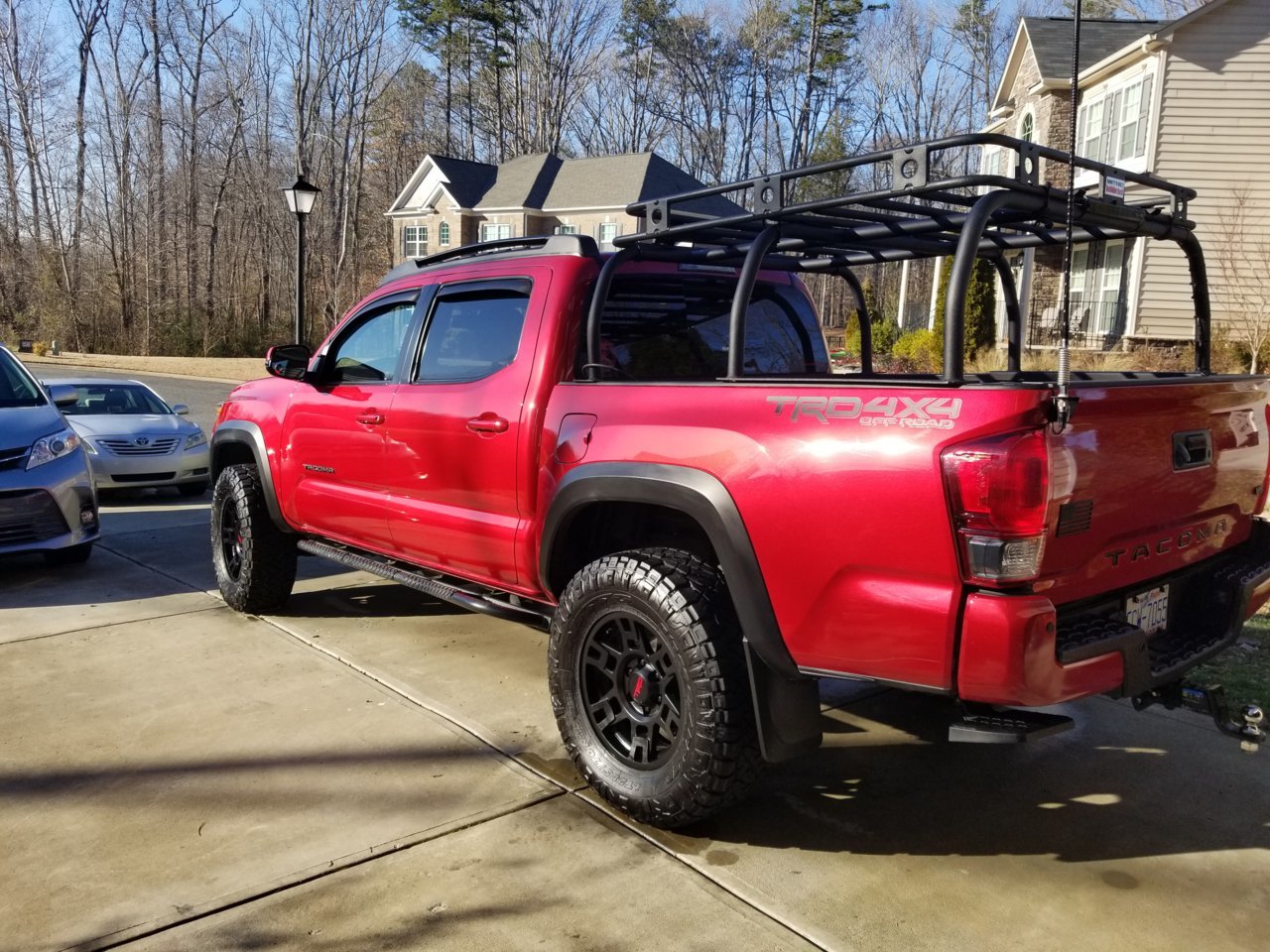

    Yup. I cut a lot. Even part of the bumper in the inside corner. Finally no rubbing...except when gunning it in reverse and locking the wheels to the right. But I don't do it often so I'm good. I love the stance.
    Full OME lift, 1.25" Spydertrax spacers, 4Runner Pro wheels, black gorilla lug nuts, 285/70/17 Nitto Ridge Grapplers.

    But do you think with smaller 265/70 tires it would rub? I think your tires are 33” tall right?
  12. Feb 25, 2019 at 4:29 AM
    remgu2000
    remgu2000 Keepin' on keepin' on.
    Aug 29, 2016
    #195912
    1,568
    Ray
    Roswell, GA
    Used to have a 2017 Barcelona Red TRD Off-Road DCSB 4x4
    32.71" to be exact. Nah, you'll be fine with up to 265/75 tires. I wouldn't worry.

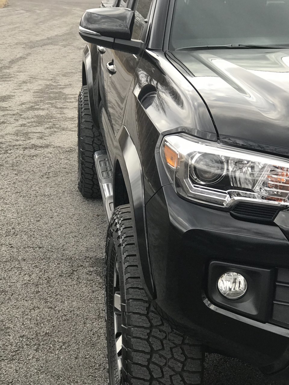

    Thanks, I mounted the tires but I think I need the spacers..
