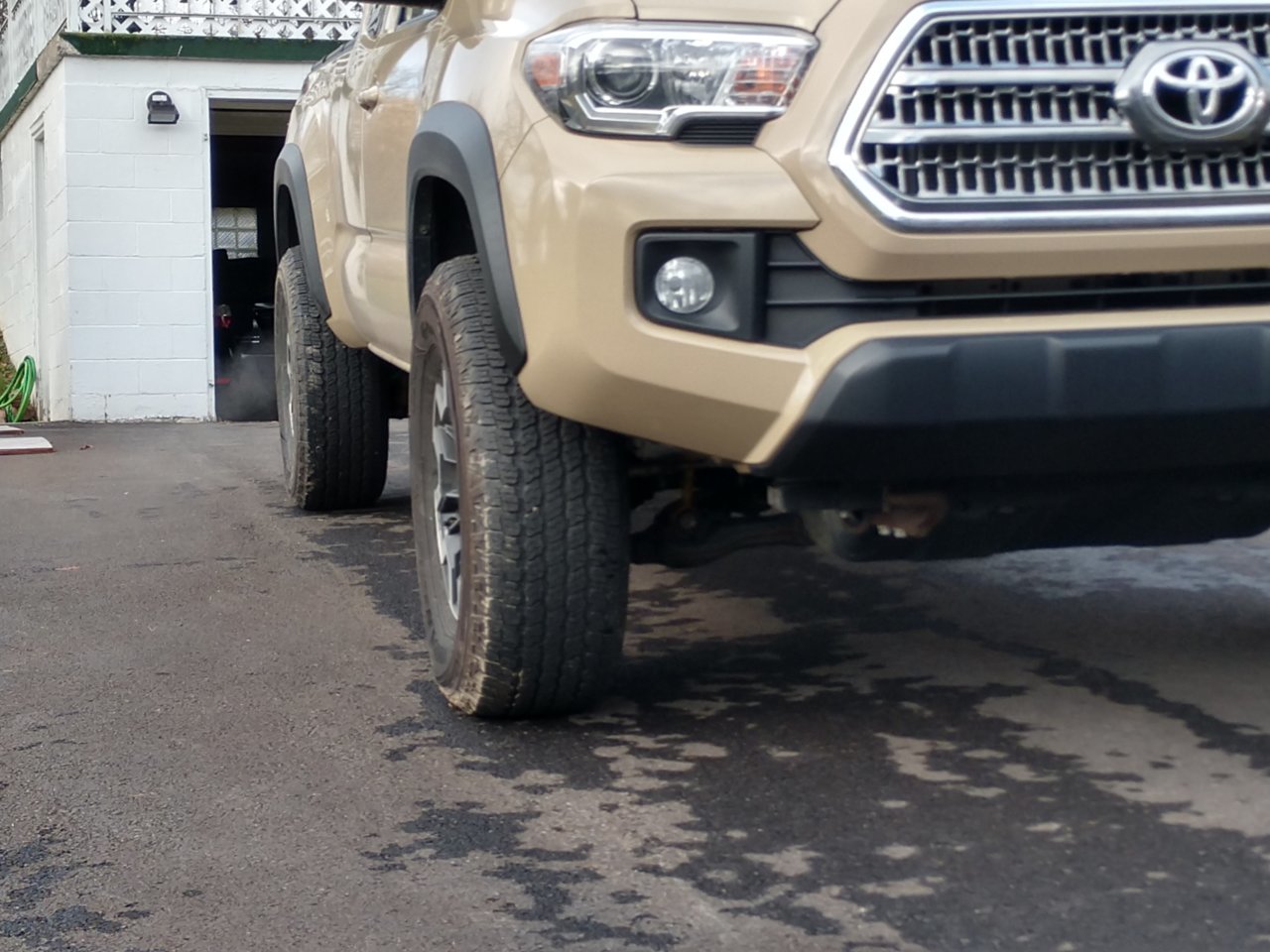

    Installed, pretty simple installation. Not including the wheels on and off the first one took about 20 min, all the others about 5 min each. Not the best pic, but I haven't seen the sun for weeks... stock TRD OR wheels and tires
