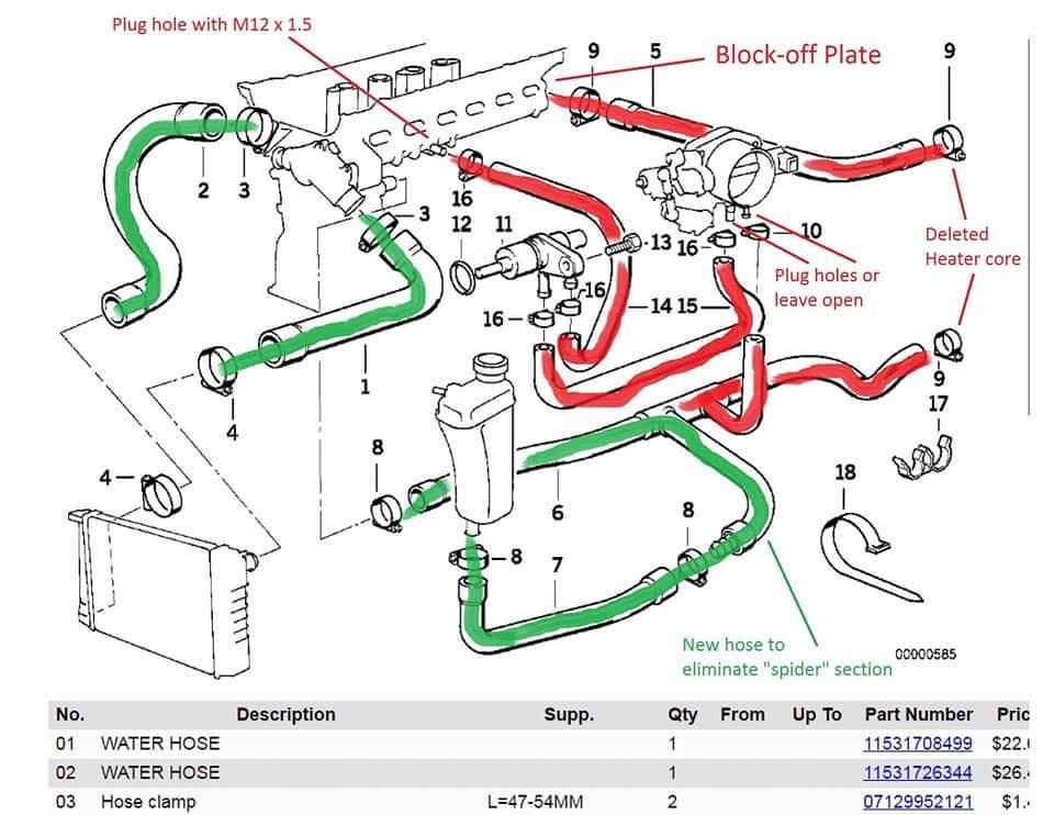

    Deleted the heater core and installed a water temp gauge. This is a bear of a project, but needed to get down to weight, get hot water away from your legs, and clean up the under dash area. Installing the water temp sensor involves remove the intake, which is a fairly involved process on these cars. The heater core delete requires some hose rerouting, so I'm keeping this handy guide alive and searchable on the internet because it was so valuable to me.
    MORE wire harness thinning. I seriously didn't think I'd ever get the car running again after this.
    Blocked off hole where the heater core was.
