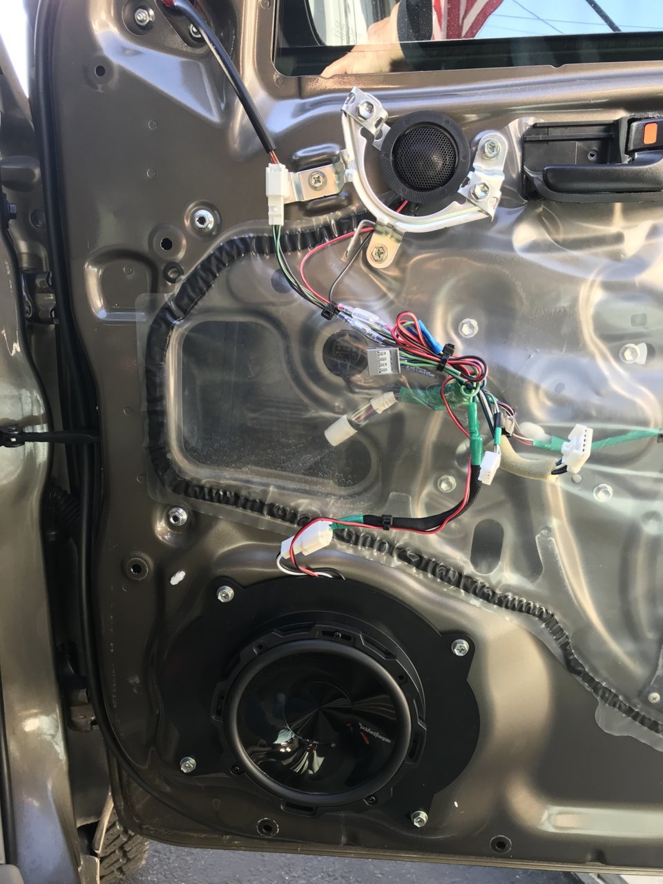

    The front door speakers require cutting and not exactly plug and play. You need bend the included straps for the tweeters and rework the wiring for the speakers. Stock configuration, the audio passes thru the upper speakers to the lower speakers. Pretty simple to wire in the new speakers.

    Do you basically cut the connector that runs into the stock tweeter. Extend the wires down to the woofer with built in crossover. Then run a wire from the woofer/crossover to the tweeter?

    You are correct. I’m not sure about *********, I’m comfortable with wiring so it wasn’t an issue.
    If you’re replacing the HU you’ll be fine with this.
    The black zip tie is where I spliced into the factory harness. I left enough on the factory harness that I cut off to reverse in the future if needed. I zip tied the factory so I wouldn’t lose it.
