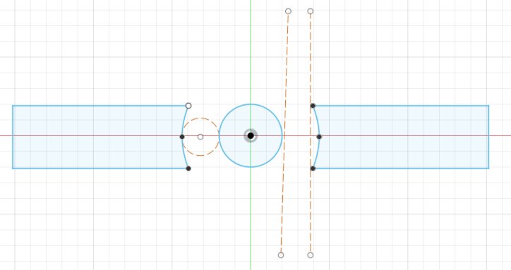

    I'm sure it doesn't matter, and it would be close enough... but here is a depiction of a wire gauge vs coin gapper and why the coin gapper wouldn't be as accurate:
    With the wire on the left side, it takes the slight curvature of the electrode into account, where as the coin gapper with the continuous taper would be "different". Is it enough to matter... probably not.

    might as well measure the curvature offset while you have it CADed (rightmost vertical line to the centerpoint of the arc)... then reduce the 0.043" by that much

    it was just a quick sketch, and it was not to scale at all.. already closed fusion :notsure:
