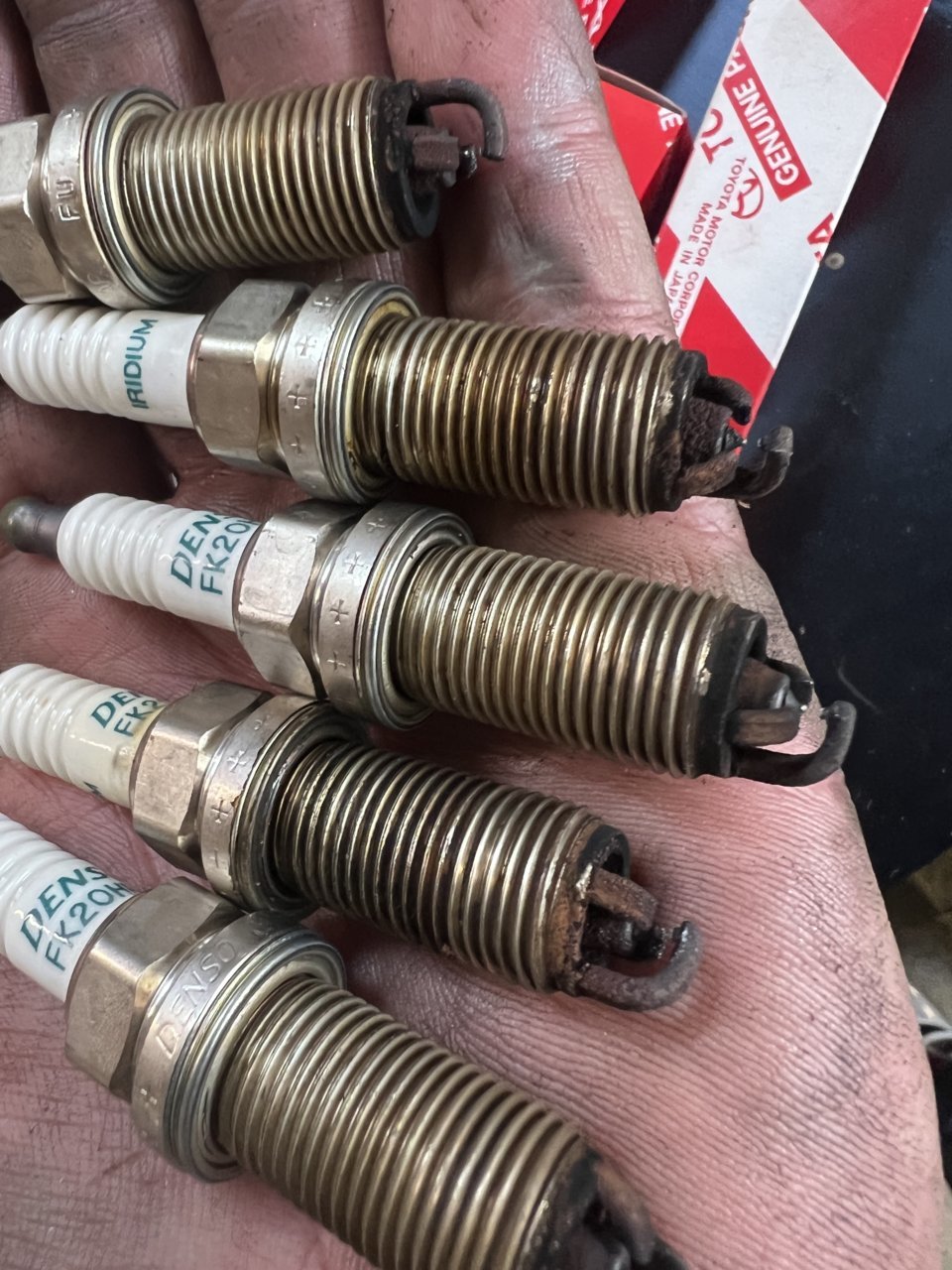

    Changed my spark plugs today for the first time on truck at 149k miles. Bought the truck with 1,858 miles on it. Bought from a Penske Toyota dealer. Had perfectly clean title came with extended warranty which is now ran out.
    I’ve put 93 shell gasoline in it since I’ve owned it and Ive added sea foam a few times per year since owning. I also add Lucas octane boost now and then. Not saying it’s caused by anything in particular and the truck is running great but I’ve ran kd maxx 6.0 tune since 82,000 miles then recently switched to the ott tune at 141k miles. I’ve had a mention that they look rusted but the truck has always ran great. Hoping it’s nothing but additives or carbon build up. Opinions and how would I check the heads for water to see if it is rust? IMG_3592.jpgIMG_3593.jpg

    That's what old plugs look like. Frankly they're about 50k overdue IMO. Were you expecting them to be cleaner?
    Are you adding the seafoam to the engine oil? Why? That stuff is for old pushrod engines from the 60s/70s. The buildup on the plugs is likely from the additives.
    Are you worried about water in the fuel causing rust? Water in fuel is not as big a problem as TW thinks it is..

    2nd this, been tuned for 75k and had about 40k on KDMAX early versions before plug change....and the awesome Pro v9 these days. They had none of that build up. I don't just take short drives, run a catch can, and also don't use additives. I am sure I could have run the plugs longer but I like round numbers so 100k was good for me

    Way overdue, damn, supposed to do it at 60k

    Just a question and yes I know they were overdue and I’m glad I changed them. I put the sea foam in the gas tank every 10th or so fill up basically every 7500-10,000 miles or so I put a can of it in the tank

    I will also agree, the plugs look good. As in good for old and overdue.

    They look pretty good for 150k…keep doing what your doing

    No, the plugs are supposed to last 60k miles for this truck.

    149K miles, that is awesome OP! This pretty much proves spark plugs last forever in modern engines. I change spark plugs just to have something to do, but that 60K limit for the Tacoma is completely random and a total joke.
