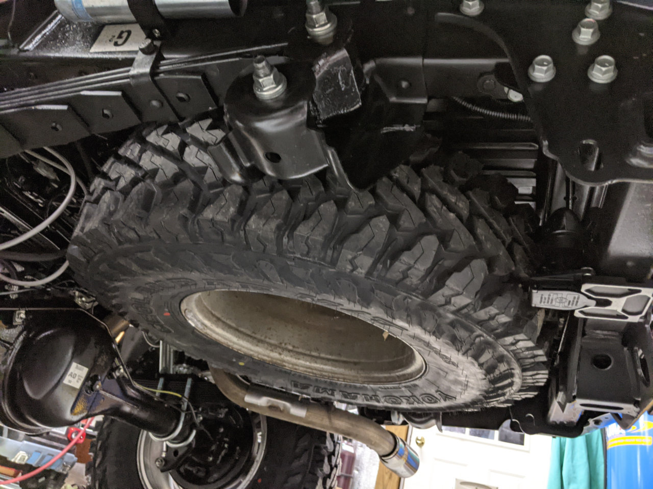

    do you need a winter spare? I run blizzaks but have just used my “summer” spare when I needed it. I’ve lost 2 blizzaks over the years and it’s worked out fine.
    Another alternative is to put it under the bed where the regular spare is if you really want a winter spare.

    And I'm planning on getting 33s and a lift, and read that it would be a super tight fit in the spare spot for the full size, if possible. And any time we're out camping it's usually well below freezing. To be honest I'm not sure how the summer tire would fare when we're on un-plowed trails because I haven't pushed it much and have stuck to roads on my stock tires, so pretty limited experience there. But I'm usually beyond recommended distance with a smaller tire.. Not impossible, but preferred to have the full spare for snow trips.

    33s is a good call. I run them and the spare fits fine underneath. It's snug but not touching anything. If your summer spare is closer to an MT rather than a highway tire, it'll do great in the big snow off road. Ice / slush on-road is another story but that'd be mitigated by your 3 good snow tires. You'll only be doing it temporarily so you'll be fine.
    What I'm saying is I wouldn't hesitate to run my 255/85/16 Cooper ST Max spare in winter off-road situations and on-road get-me-to-discount-tire situations when one of my 265/75/16 Blizzaks pops. I think it's a much cleaner solution than risking damage to the truck / cap / dog if that tire is mounted like you want.

    255/85-16 fits underneath easily when you bend the locating tabs out slightly.

    Spotless frame. Nice

    Malamute rides shotgun. Corgi on the floor. Adjust the OEM spare bracket slightly to fit the 33. Girlfriend in the bed. :)
