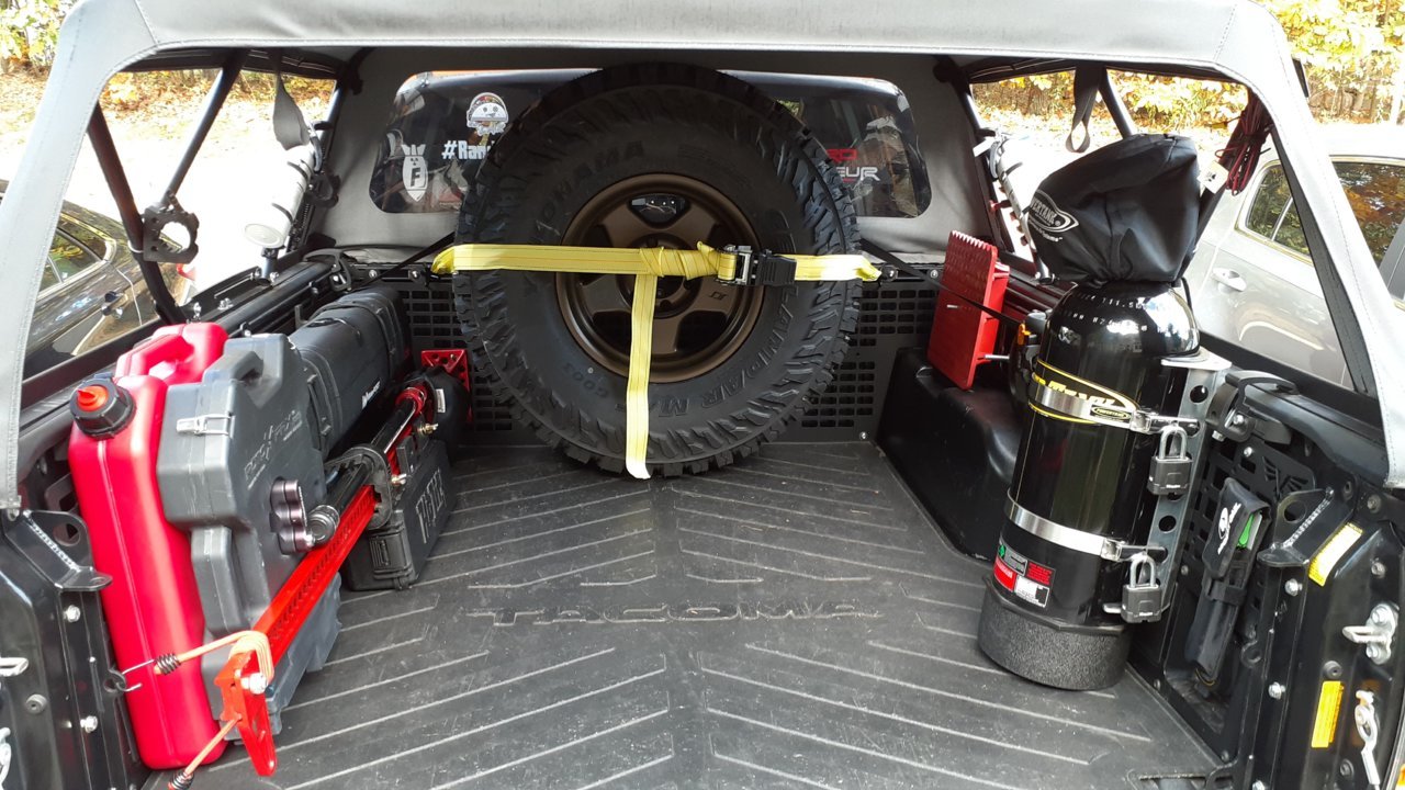

    What about using something like this
    https://www.ebay.com/itm/2PCS-Tie-D...hF2og2Q8hysiLeVkRu9se9QRPzSa0B48aApjfEALw_wcB
    And a quality ratchet strap?
    consider that there are multiple posts about mounting your spare against the side of the truck causing cracking in the bed...
    https://www.tacomaworld.com/threads/a-warning-about-bed-rail-tire-carriers.285889/
    while there aren’t the same issues about mounting your spare against the cab in the bed against the back wall...
    notice the second vertical ratchet strap tied to L-track that I bolted directly to the bed.
    I’ve had my spare mounted this way for about 50k miles including aggressive wheeling with no issues

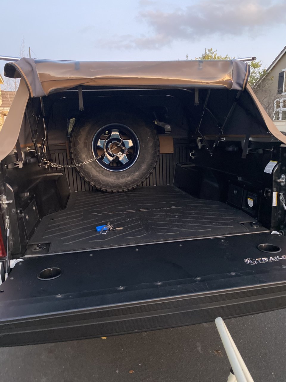

    Used this:https://www.google.com/search?rlz=1...ymAEAoAEByAEIwAEB&sclient=mobile-gws-wiz-serp for a bit. Went wheeling twice with the setup and no wobble, but made a few trips to Lowes to make the setup work.
    Recently changed the setup because I needed more space to sleep so I took the mount off and turned the wheel and leaned it against the wheel well. Used a ratchet strap and chain/lock to secure it.
    71tattooguy likes this.

    I imagine there’s a little movement if you just strap it to the bed rail, that’s why I also strapped mine down to the bed

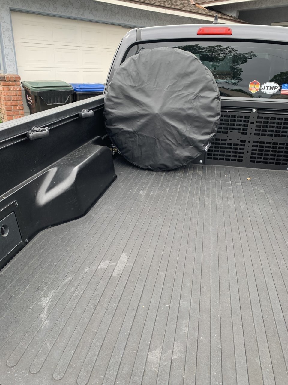

    Wilco bed rail spare tire carrier under the cover.2B0F08BF-795A-495F-9C11-6A7A6C249A02.jpg

    The question of the rigidity of the bed rail came up. The Wilco mount is bolted to the bed rail and to the Cali raised molle panel, which is bolted to the bed of the truck. The tire sits on the bed of the truck so it doesn’t hang and break the front bulkhead.

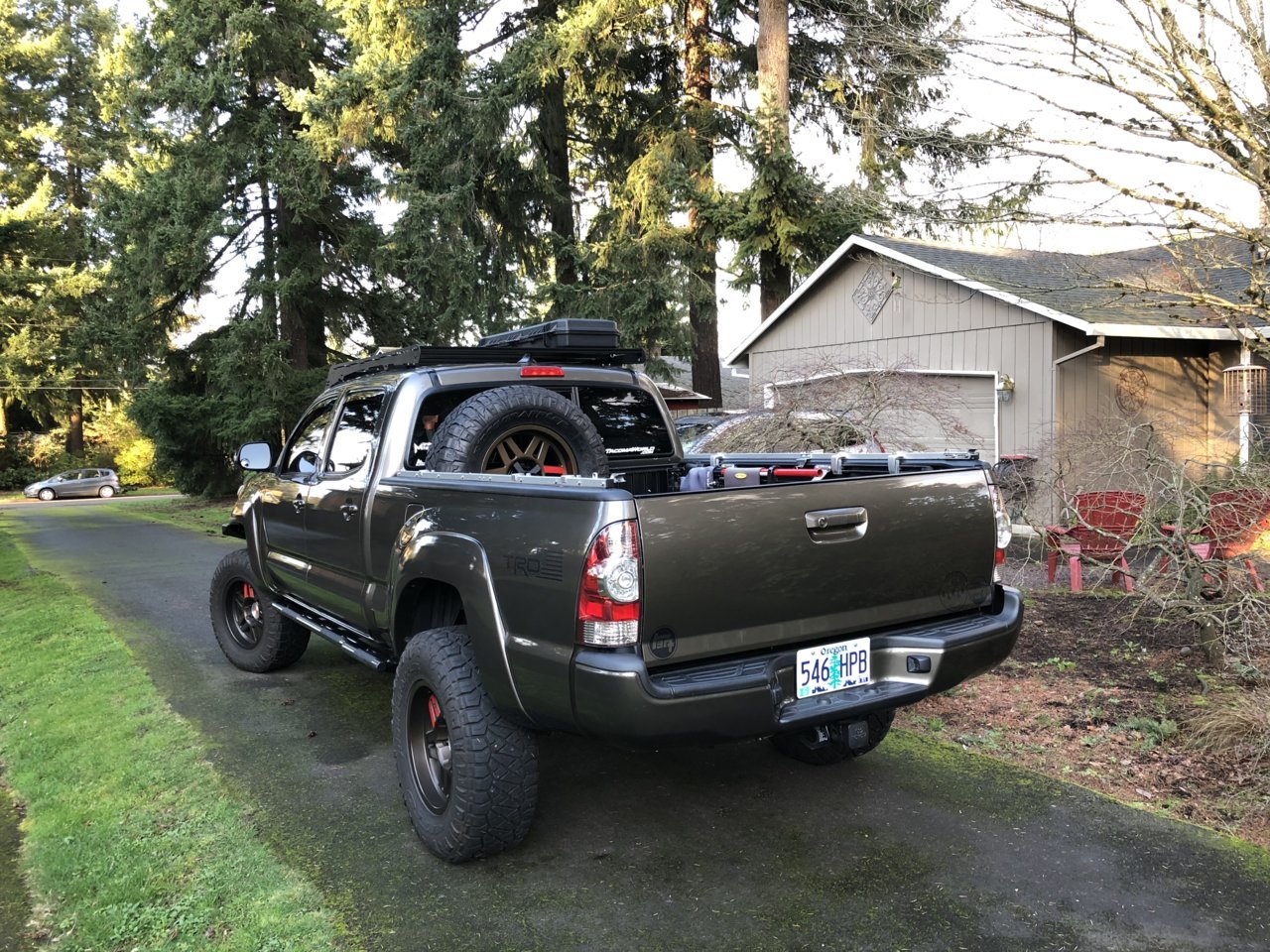

    Wilco tire carrier.

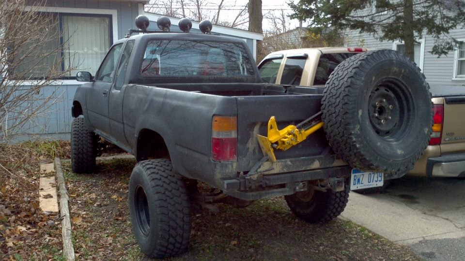

    Does anyone have their spare mounted on a swing out from the rear bumper that DOES NOT have a topper on of any kind? Any pics?

    I like the spare tire on the tailgate but I would have to perform surgery or use one of those erector set contraptions that hook into the trailer hitch.
