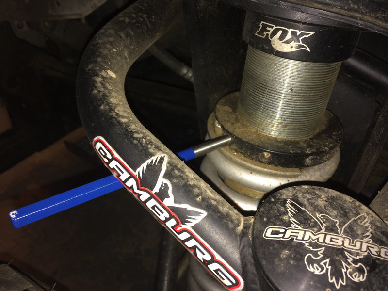

    i used a punch, worked fine. It looked like to me about the only thing that would fit anyway.
    Fit in the coil mount I mean, the spanner I have may work to turn the collar but there was no way it was fitting inside the bucket.

    I don't know if it's the best way, but it worked. The wrench I had wouldn't fit inside the coil over mount and I needed to get my truck to the alignment shop. So I used a punch that fit the holes tightly. If there's a better tool that works that might be better but the punch got it done without ovalizing the holes.
    Edit: My punch is actually a 5/16".

    I mean an actual 5/16" pin punch.

    I used a cheap HF screwdriver that we ground down to head so it would fit tight in the adjustment notches. The trick to not ovaling the holes is to get something in there that will fit snugly and bottoms out in the hole as much as possible. If you're only halfway in or there is some play in the tool you are using you will oblong the holes, guaranteed. After all you're using a hardened steel rod in and aluminum piece. As an aside I will say that if you have reservoir shocks the curved adjustment tools are usually too big to fit in the coil bucket and around the resi hose. You're better off using a straight punch or dowel.

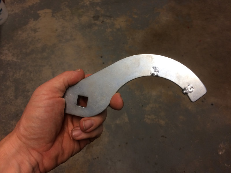

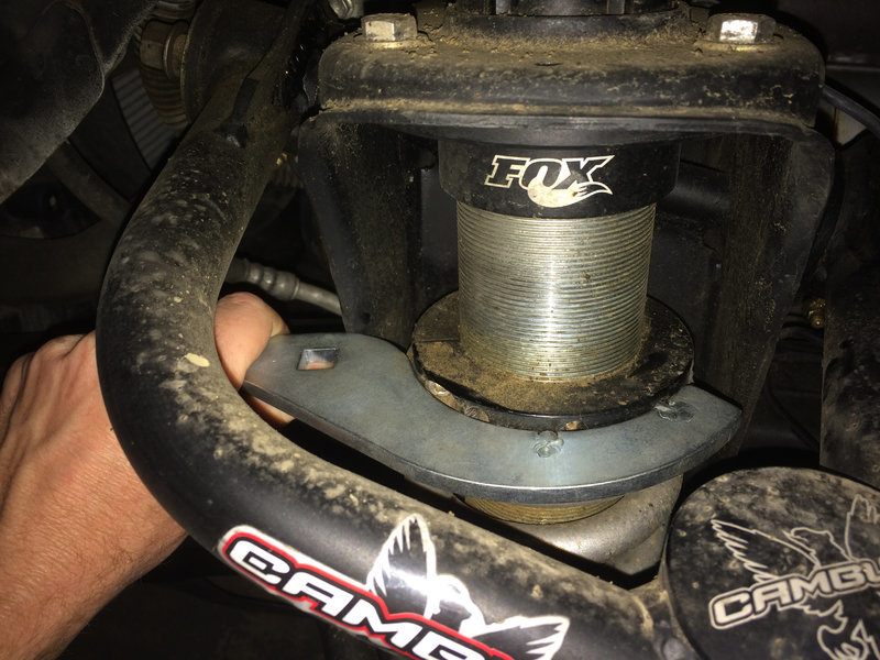

    I got mine at ORW for about $15. It was Laser cut and hanging on the wall with all the various tabs. I am sure you could call them and have it shipped if you are not from So. Cal.

    Just found the Tool. Its a little more than $15 from what I paid years ago. But this works perfectly.
