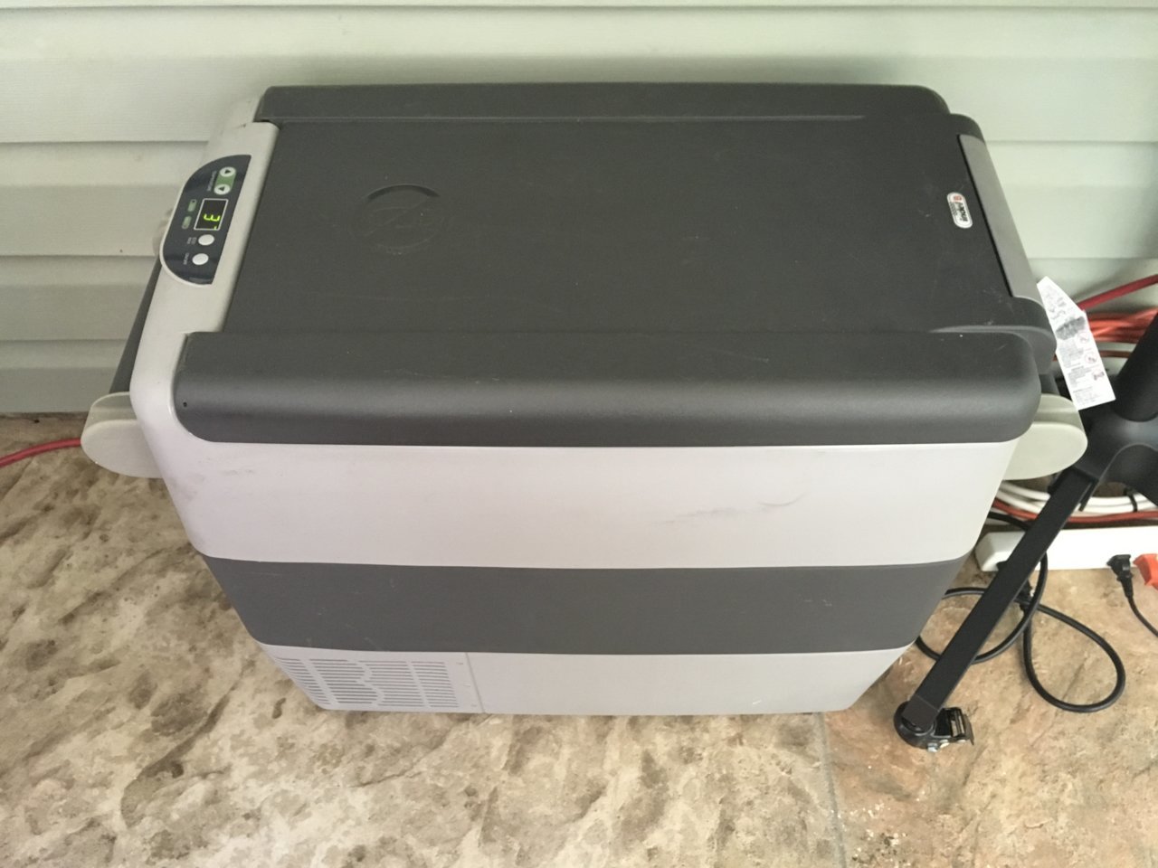

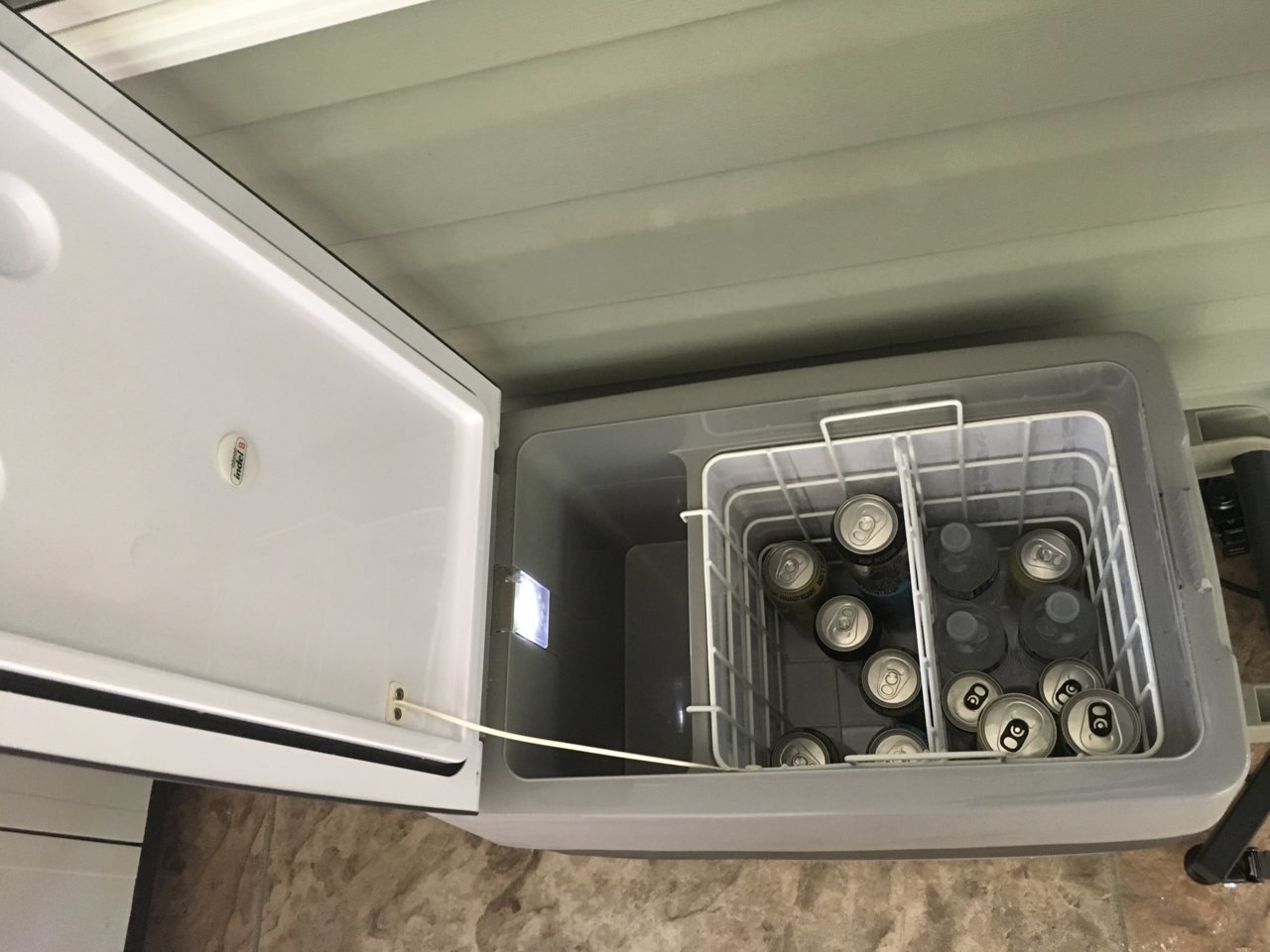

    Package deal? Trades (I usually don’t know what I need until I see it)? :notsure:
    I think I even have a mounting plate with quick release for the fridge/freezer...would need to try and find it. Was going to put it on the bedslide.
