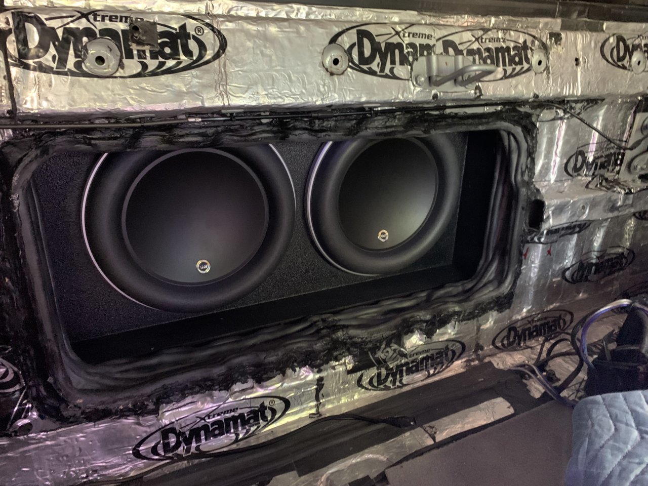

  20. Apr 18, 2023 at 5:01 AM
    #20
    NavyDiver72
    NavyDiver72 I DO ALL MY OWN STUNTS
    Mar 18, 2013
    #99967
    409
    Rick
    Millington, TN
    2006 DCLB TRD Sport PreRunner
    Any Mods? One. Maybe two, tops...
    IT’S 80’s COOLNESS :cool::thumbsup:
    Fiber Mat 45 will DEFINITELY be too thick for the door panels, but it will fit fine on the back wall where you get a lot of road noise. I’m using Second Skin Luxury Liner Pro, which is 3/8”, thicker than FM 45, and my luggage bins fit just fine.
    I know what Nick says about compression, but some compression is acceptable.
    Like you say, get one sheet of each and experiment.:thumbsup:
