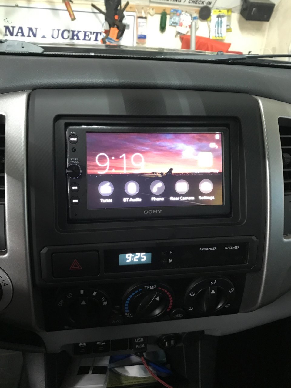

    Here is my install. I did it last week. I bought it and the wiring harness from Crutchfield. Super easy. The only thing I still need to figure out is how to get the backup camera to come on automatically with reverse.
    Beauxdon and Tacoma77[OP] like this.

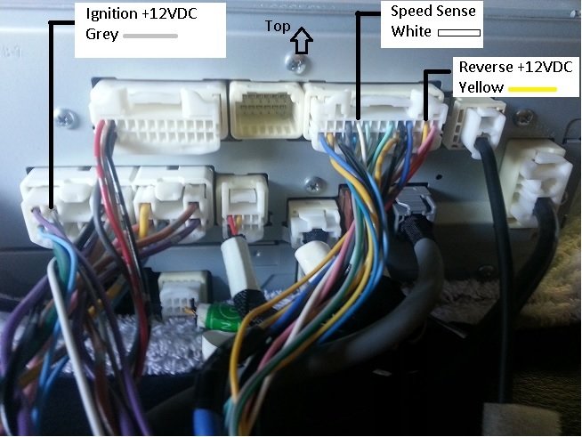

    If it had a touch screen from the factory (or even if it didn’t) you might get lucky and the wire is already there
    This particular image is for a tundra but it looks like all the taco’s I’ve worked on.
    If there’s nothing like that, you can always get a trigger from the reverse lights. Head to the drivers side kick panel

    I hooked the reverse wires from the new harness to the new radio harness that said reverse. I will try going directly to reverse lights

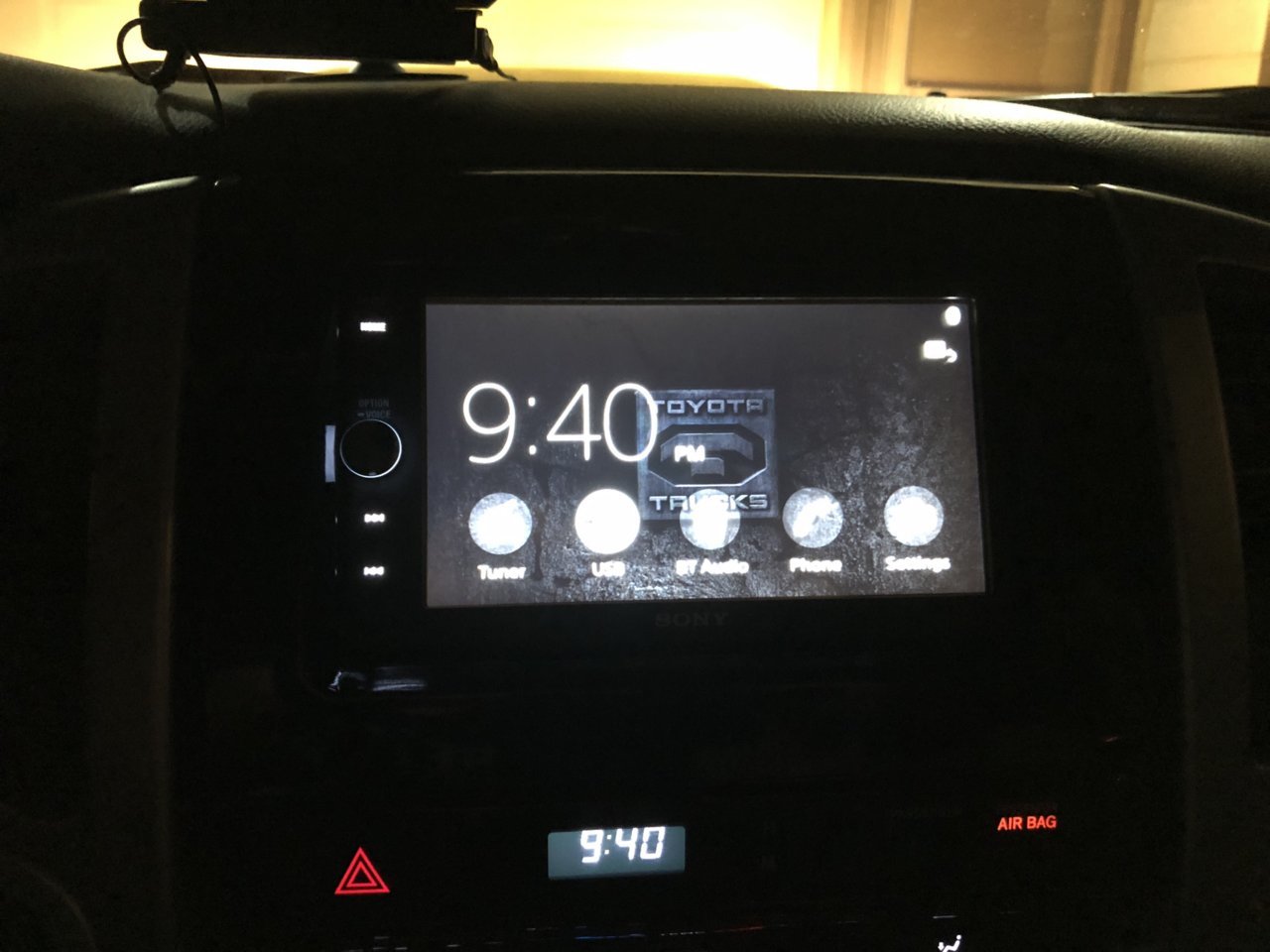

    Here’s a crappy night time shot of the head unit. I couldn’t be happier at this price point. The sound through my Alpine amp and speakers is far better than it was with the stock unit and a converter. Sony seems to be making some good stuff, especially since the last time I bought a head unit it was only maybe a $100 cheaper with half these functions and way crappier sound lol.
    sbates likes this.
