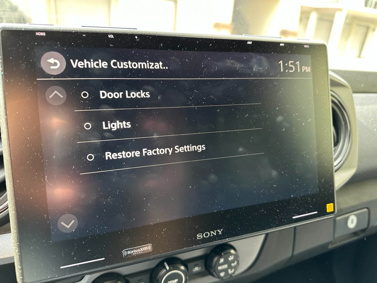

    Hey @trd_semipro - I am researching this and got most of my answers. The last remaining question is about vehicle customization that the stock unit has such as door lighting, door lock controls, vehicle maintenance, Vehicle alerts, etc.. Does the 9500ES retain all these customization settings?
    Really appreciate any help you can offer. And not to piss anyone off but I work at Sony and can get the unit for $350. TGP said they would sell the harness only, so i am happy but want to make I lose nothing by switching.

    with the maestro rr you can get almost all of that. The outlier here is the vehicle maintenance reminders but the light delay, drl, door/hood open, tpms all is there

    But can you configure and customize the door to close after X speed or when gears shift from P? I am asking specifically if the head unit has the same UI that the Tacoma radio unit under Menu->Settings->Vehicle

    Not the exact same UI.
    Settings - Application - Maestro - Maestro Settings - Vehicle Features - Vehicle Settings

  7. Mar 2, 2023 at 2:31 PM
