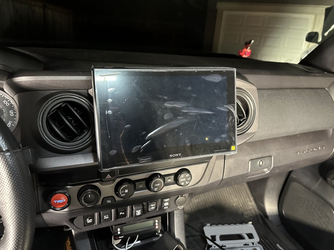

    Installed not too long ago. So far I’m pretty happy with. Some might not like how much it sticks out but I don’t mind. Just happy to have CarPlay now.
    Also installed the Oem Audio plus speakers. Sounds good IMO.

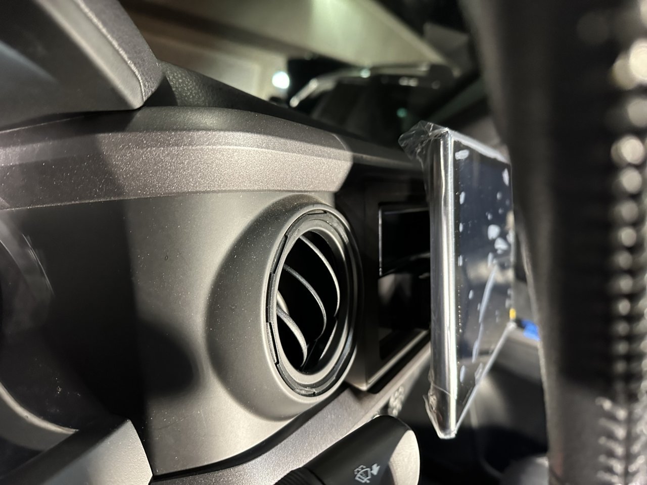

    Is it possible to have the screen sit more flush with the dash? Looks about a 2-3 inch gap between the screen and bezel.

    The gap isn’t that wide it’s closer. But it’s as close as you will get unless you move the main body in further to the dash
