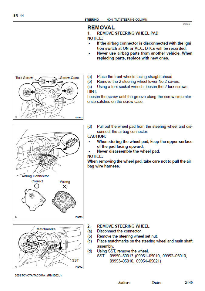

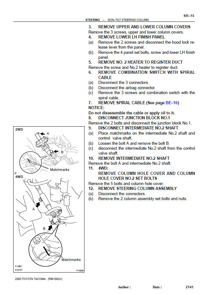

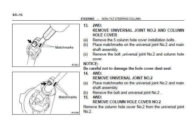

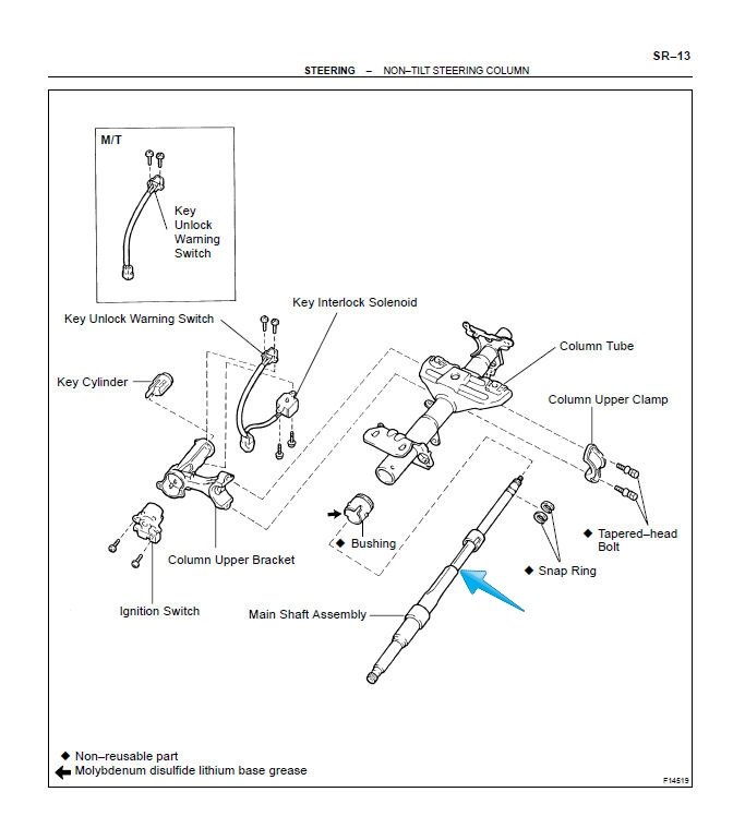

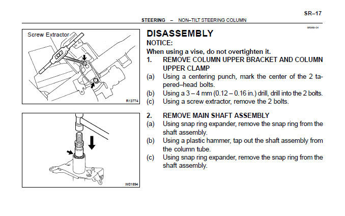

    The non tilt units do appear to suffer from this problem (post #61 in the TTORA thread). From the diagrams below, the slip joint section of the steering shaft looks identical to a "tilter". The low mileage/abuse of your rig suggests to me that if you do have this problem, it might be just beginning. Just a thought.
    Go back to post #1 of that thread to the "Diagnose Your Truck" section. Instead of holding the lower end of the shaft with your hand, use a pair of Vise Grips. Then give things a twist, you will get a much better "feel" for any play or clicks because it looks like pulling a non tilt steering shaft is a lot more work.:(
    The non tilt column procedure is very similar to the original tilt column procedure (removing the entire column assembly) before the short cuts were developed. The reason being that the steering shaft must be tapped out of the "column tube" in the opposite direction as the tilters. Hence the need to remove the entire column assembly then remove the shaft.
    These pages are from an online 2003 FSM but as far as I know they should be the same/similar to the 95s. They are the same as my 99 paper FSM.
    The removal process is very confusing, make sure to follow the "4wd" steps.
    Red arrow shows location of slip joint, covered by the column tube.
    d7323cc7-15c2-4882-a7d9-ed7a16ae1645_zps_12d5ca670b80c5a7dd502023ac020bfe57f88f59.jpg
    Blue arrow points to slip joint.
    87c8be54-71eb-4940-9933-b33f9b5ca422_zps_170120efa076f0771c0009de8b7ea003b35c8d11.jpg
