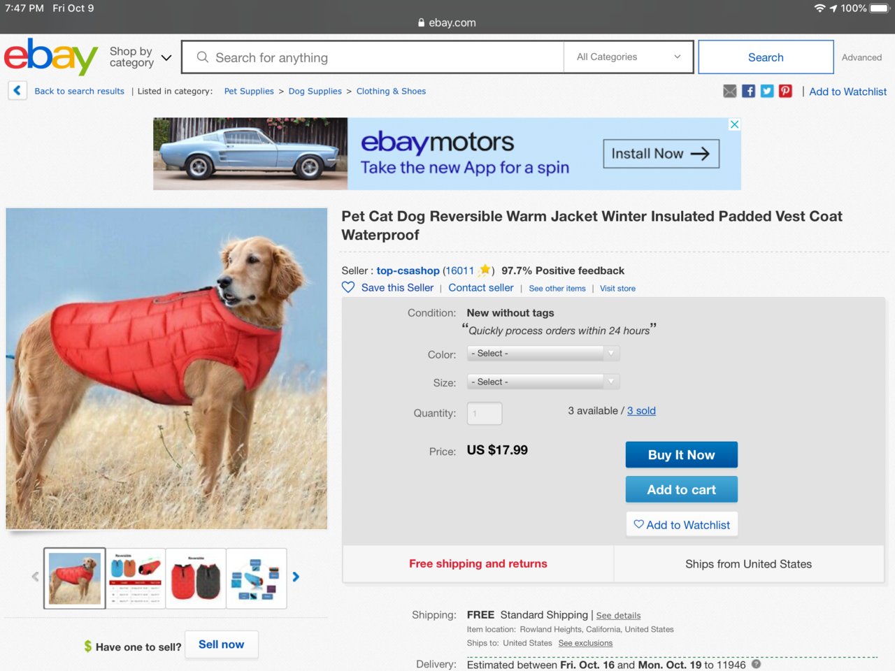

    For your doggy you could get him/her a insulated vest.
    4x4spiegel and Grossomotto like this.

    Actually, I hadn't really thought of that. She doesn't really like to wear certain things, but loves her harness and trail pack. This way, I could just use the heating pad to keep her water unfrozen.
    I've also thought about a ceramic heater, but those seem like more of a hazard to catch something on fire or burn her nose/paws.
    spitdog[QUOTED] and wilcam47 like this.
