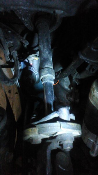

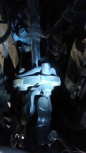

    As far as getting out of completely removing the rack & pinion, and only undoing the connection between the gear and the steering shaft ... found the reference to dirtypool's and loronzorizo's post here: https://www.tacomaworld.com/threads/steering-wheel-off-after-rack-alignment.452922/page-2.
    Seems there's a way to remove the rack from the steering column shaft ... on his 2003. I looked at my 1995 and it's a bit different. There's a bolt that tightens the steering shaft over the pinion shaft with the splines. Above that, looks like the the only thing is the connection to the yoke. Is the yoke that, if removed, will allow enough flexibility to disconnect the two?

    Yeah, that's the thread I remember reading. I haven't done the repair but following dirty pool's lead is always a good idea.
