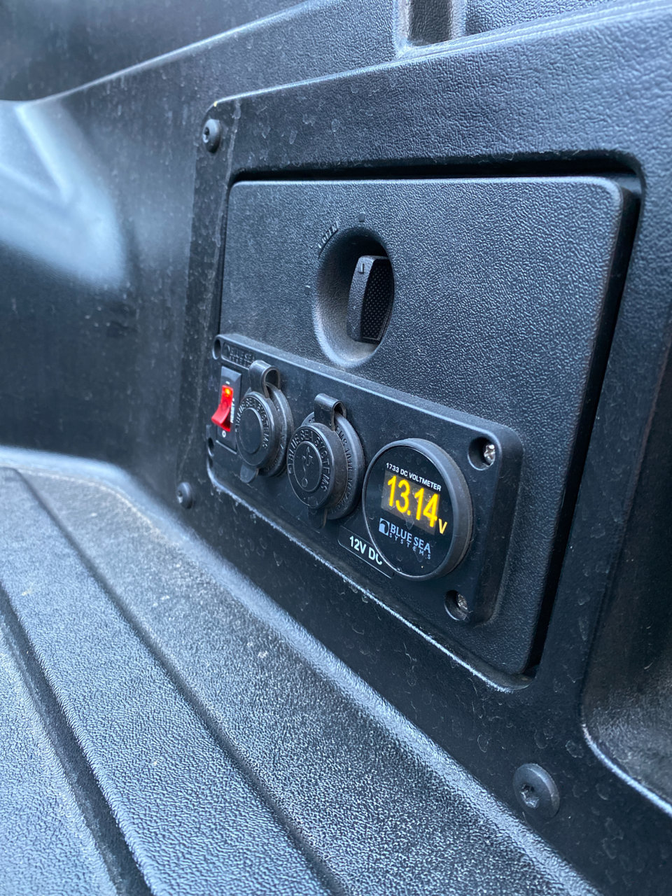

    I ran some 8 gauge wire to the back and put one of these panels on the cubby. Connected to the battery, fused, and a breaker switch.

  8. May 28, 2020 at 7:57 AM
    RubenZ
    RubenZ Well-Known Member
    Feb 16, 2020
    #319467
    452
    South Texas
    2020 Cement Tacoma TRD Off-Road DCSB
    Thats my PLAN. Good Job. Is the FUSE etc built into that panel or you have it by the Battery? Or is it built into switch?

    Yes. I misspoke. I was referring to breaker and not the fuse. But I read now that the switch is the breaker.
    Skydvrr[QUOTED] likes this.
  12. May 28, 2020 at 8:56 AM
    fake4x4
    fake4x4 Well-Known Member
    Jun 20, 2015
    #157787
    892
    Los Angeles, California
    3rd Gen Tacoma TRD Off-Road DCSB
    Cool stuff
    fused at the battery, there is a breaker switch at the panel.... the panel is good for 30A
    tonered likes this.
