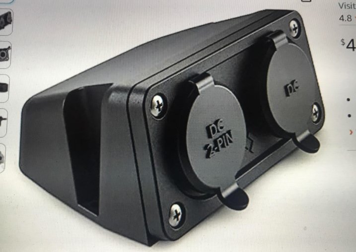

    Since the SR5 only has one 12v location, which will be used for my brake controller on the camper, I'm looking at this
    to be installed inside the cab and hardwired to the battery... or do you think a Goal Zero Yeti400 would work with it.

    I've got a TRD Off-road and it's only got one 12 volt plug as well. I'm thinking of adding an additional 12v one like you've got in the photo, though a couple friends have recommended having an inverter installed to just run it off 110 volt. Right now I've got a similar size capacity battery to the yeti 400 except mine is Lithium ion. I've found that over the course of 1 night the dometic pulls my battery from 100% charge to about 53% charge. So recharging daily is essential for multiple day trips. I found that using only the 12-volt charger the car really has to be running all day to recharge the battery and since I don't drive constantly when I'm road tripping I added the solar power set up. It seems to be working except for the glitch I mentioned in my original post, but for now I use the 12v when driving and plug it to solar whenever I stop to keep it charging. I've evolved this over about three road trips so far this year and will see how it goes as the summer goes on. I'm already thinking I might need a bigger battery though, maybe a GZ 1000X or 1500X or equivalent.. This is all new to me! I'll be interested in hearing how your setup works out with the added 12v, but I'd be weary of hard wiring it to the battery (unless you're going to install a second isolated battery and such). I've heard many stories of folks hard-wiring stuff to the battery and running the battery down too far to start the car (like I did with off-road lights on my old Jeep in the 80's).

    Also about to pull the trigger on a Dometic 35 and this 12V connector - thought it may fit nicely in the back seats of the A/C Cab between the seats
    and let the Dometic ride back there too. I'd get this hard-wired to the truck battery and/or let the Jackery set back there too and power the Dometic

    Gonna have him look at :
    A: Adding another 12v somewhere in the cab or
    B: Install the Dometic Connector in the cab, between the back seats
    C: AND.... have either of those ONLY work when the engine is running.

    Easiest way to do that is to use an add a fuse to the factory 12v plug circuit and wire the additional 12v plug to that. I’m not sure if the fuse for that is under the dash or hood. Otherwise you will need to wire in a relay so it’s only on when the engine is running.
