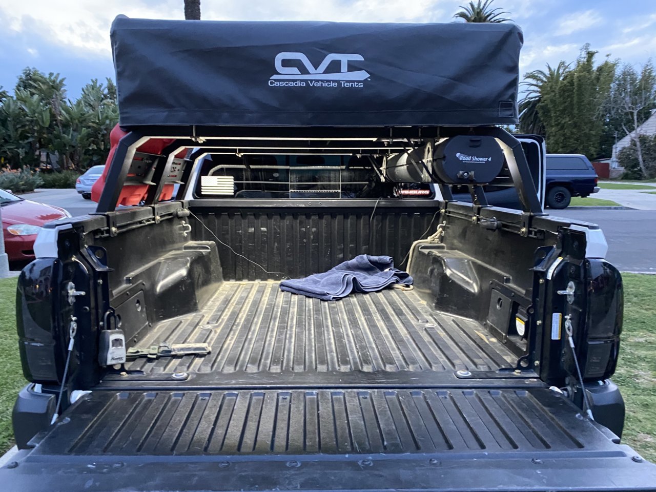

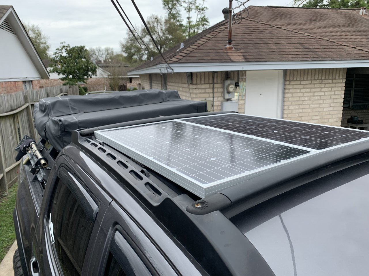

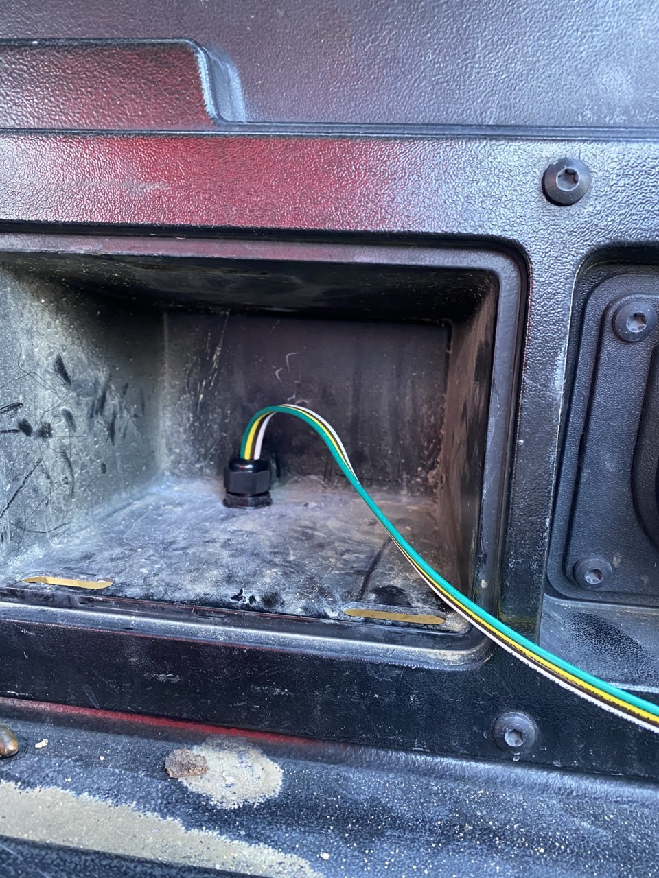

    Just finished installing my Renogy Solar Panel Kit. I'm super stoked with the outcome, it was pretty simple to install once I figured out how and where I wanted to run everything. I installed this because I wanted to be able to run lights and other accessories at night / all the time when camping and not have to worry about it killing my engine battery. Dual battery is another option, I just opted this route.

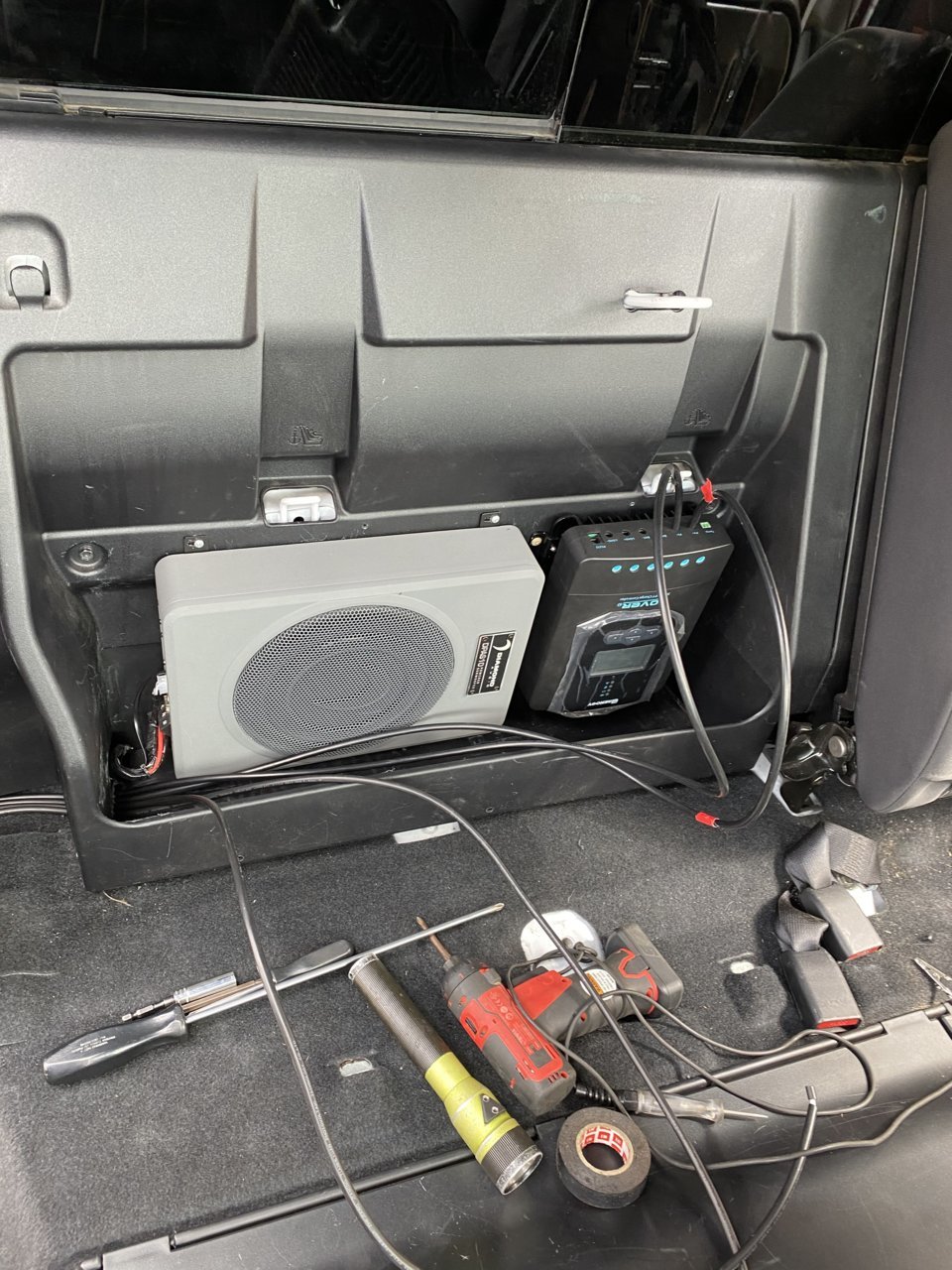

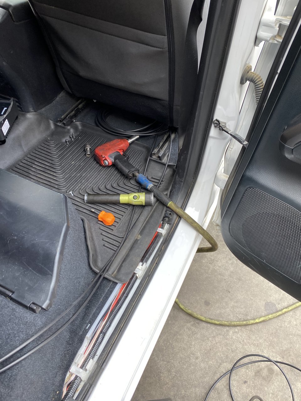

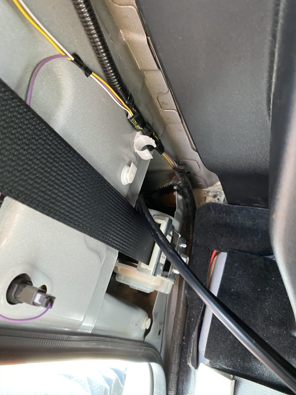

    I didn't want to drill through my roof to run the wiring so instead I ran it behind the cab. I run a road shower on my rack so you can barely even see two wires going behind my bed. Then I found a grommet that leads into the cab and fed the wiring through. I mounted my charge controller for the solar panel behind the passenger seats where I then ran the battery cables along the floor through the fire wall to my second battery. I still need to clean some of the wiring up, but for the most part its pretty clean.

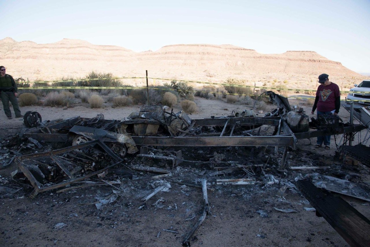

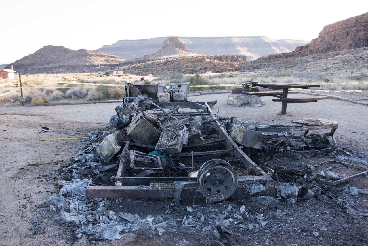

    So, the only thing I would highly recommend is a shutoff for when the battery is fully charged. My pops had a defective one, and his travel trailer burned to the ground, pets inside while they were out hiking. Sad day.

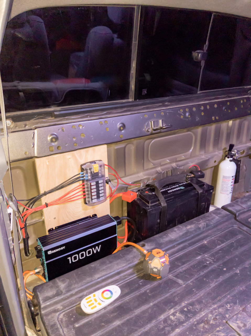

    what do you guys think about placing the battery right next to the charge controller behind the rear seats?
    I did this on my truck, the main drawback is that I had to remove the plastic paneling behind the seats to make room for the battery.

    Looks great!! I would probably put a wall between them just Incase ! A sweet shelf!!!

    yeah, tight quarters back there. I ended up going with the Lithium battery because of the weight and size advantages... my wallet was not happy tho :eek:

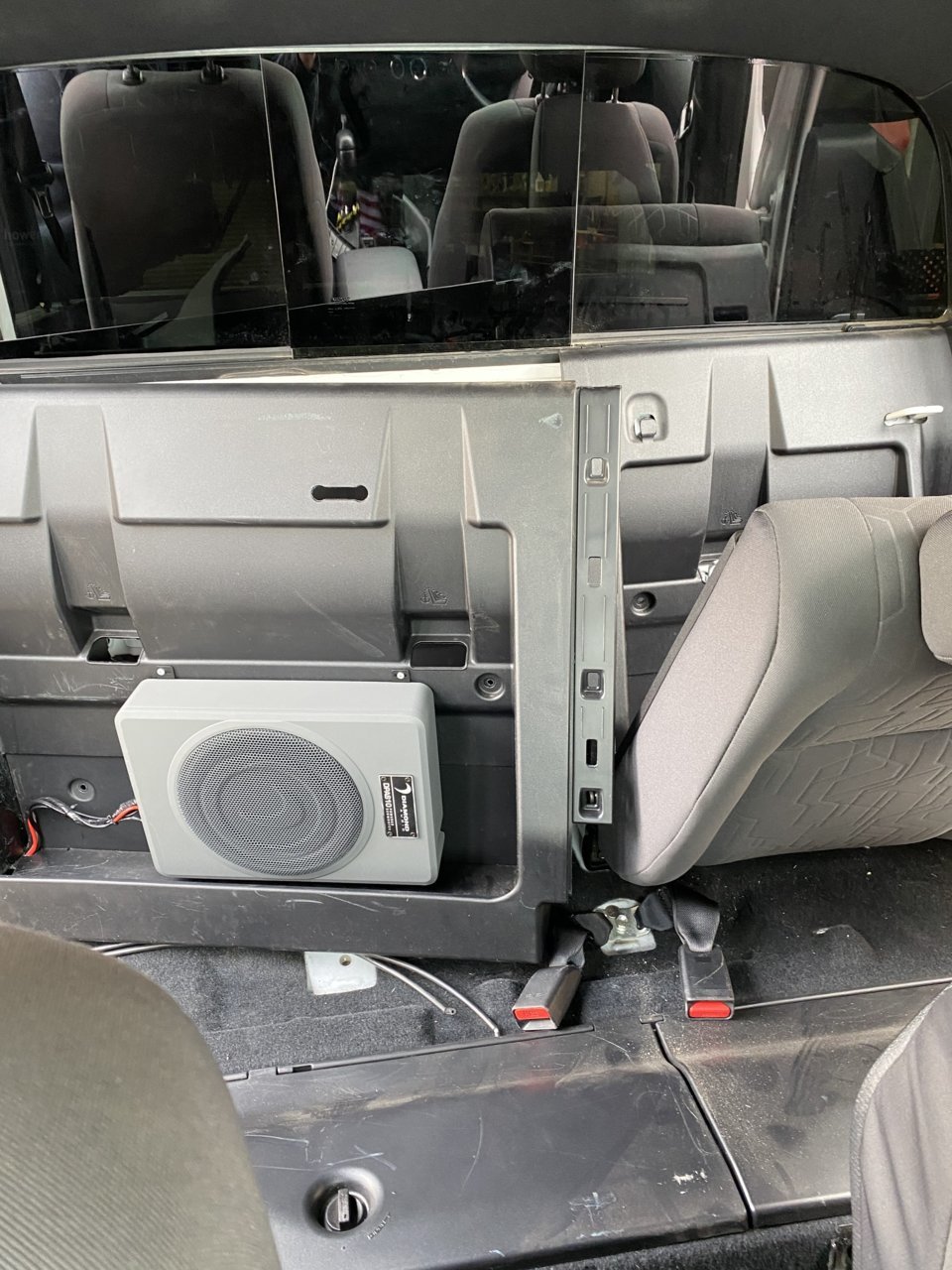

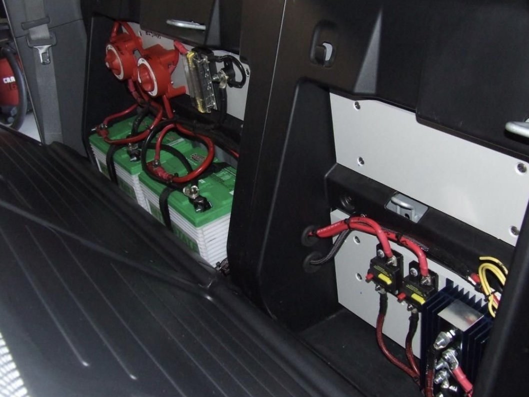

    I’m starting a solar setup as well but planning to mount everything hidden behind the seats like this (not my truck in this picture)
    and the panels to the under side of my OEM roof rack so it’s pretty low profile here
    I’m really excited about this project. :thumbsup:

    That pic of the green batteries, I wouldn’t want lead acid batteries in the cab. They look to be non sealed.

    Update: Since the initial install I contacted Renogy Solar, they told me to add a couple fuses throughout my wiring and thats all the preventive measure I would need to keep my truck from catching on fire, incase my charge controller stopped working for some reason.

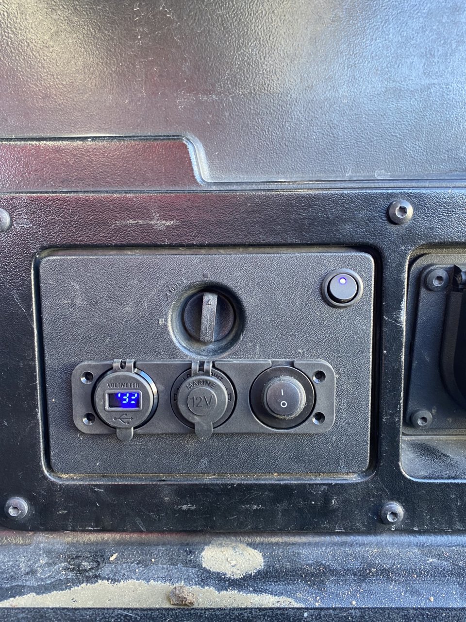

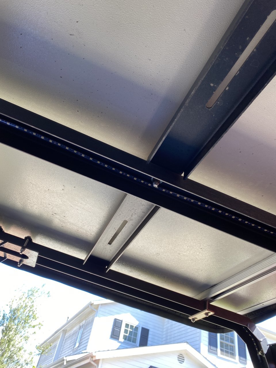

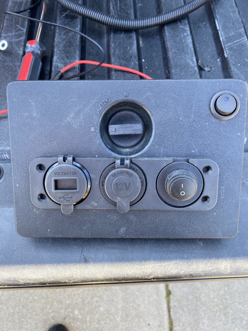

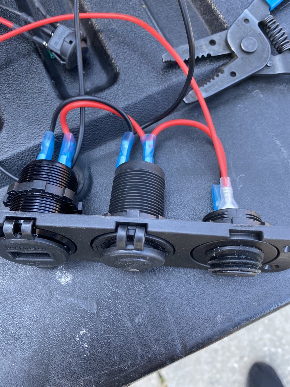

    Recently I have added some rack lights that are powered by a switch in the bed, as well as a control panel that has 2 USB chargers and 12v connection. I mounted these in the right rear cubby and seems to be working out nicely. I have been testing them / using them regularly and it is all working killer! In addition, I decided to wire up my baja designs ditch lights to the solar battery which has been working great for lighting while setting up camp at night
