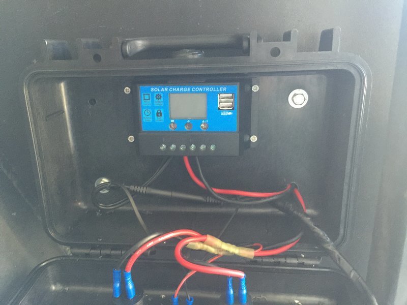

    I have 100 watt solar panel on my truck and a 100 watt for my trailer. Each have charge controllers.

    How is that panel wired into the vehicle?

    Wire does down the edge of the windshield into the engine bay to the charge controller then to the battery.

    That was for a trailer. For a truck you just need the panel and the charge controller and some wire.
