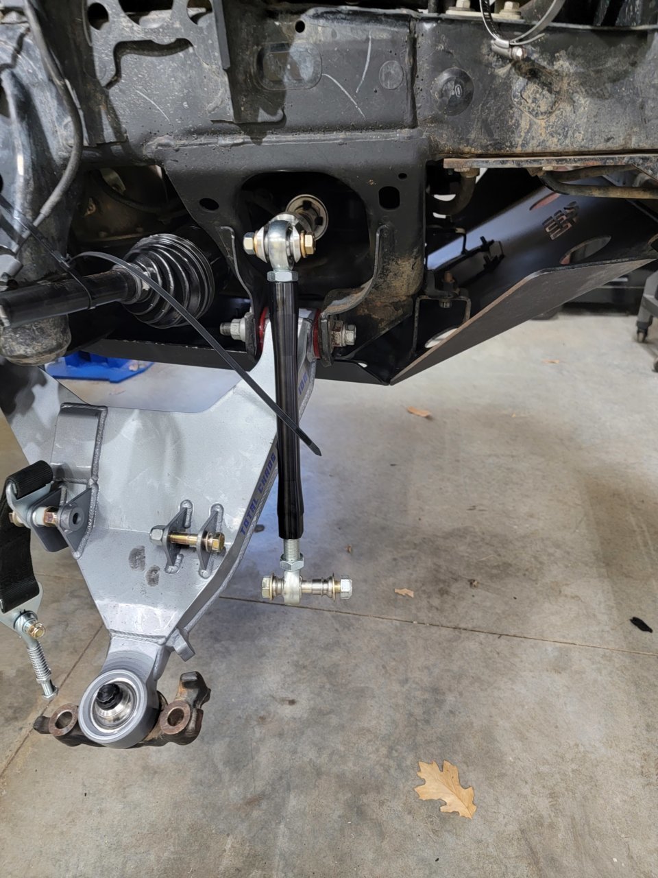

    Nope. Current status of........
    Got the knuckles double sheared, limit straps mounted, and started on fitting the cage bar and coil gussets but
    was frustrated by fitment issues and the ever present sickness. Closed at work all last week, which saps all my time, then was sick
    last weekend to cap it all off. On the plus side @Slashaar was able to get his skids all built.
    Started on the cage bar a couple night ago, which facilitated a need to go to the tool store the next day but was dampened by
    Lil2Fang coming down with strep that morning. So..........

    I'm wondering what the OD's are on the linkage between the clevis and the rack. Wondering if something like this would work, or a 'pinch' (idk what the term is) style.

    I'm probably gonna go with the @EatSleepTacos idea you planted last weekend. Got a couple inner tubes and if that becomes and issue I was thinking about adapting
    a shock boot but we'll see. We also got a new tool of destruction at 2Fang yesterday......just gotta get time to destroy with it now.

    I also saw a neoprene boot that just slips over like a shock cover. Don't know if it'd really hang on well without some criminal bondage ties.

    Here’s what ended up being my best solution. This boot, hose clamped onto the rack, loosely zip tied onto the tie rod, and soak the inside of the boot with fluid film to act as a lubricant and a rust preventative. The lube was the key to get the bolts to not get caught on the ribs of the boot. I didn’t try a normal tundra boot with the lube which might also work.
    Flexx Boot FB4000 Universal Replacement Rack & Pinion Steering Boot https://www.amazon.com/dp/B00C2M76MO
