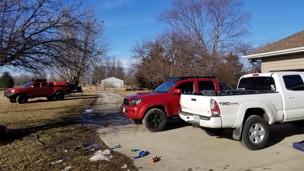

    Current pic of the Yota Fam

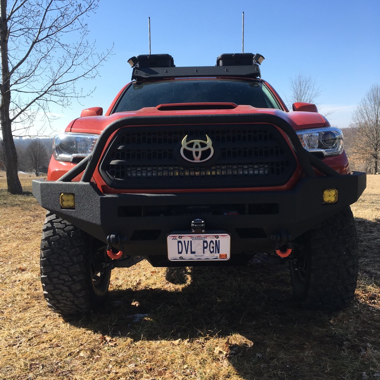

    So, without further ado......I give you "DevilPenguin"......
    Stockish on the 3rd day of ownership...
    As she sits currently....

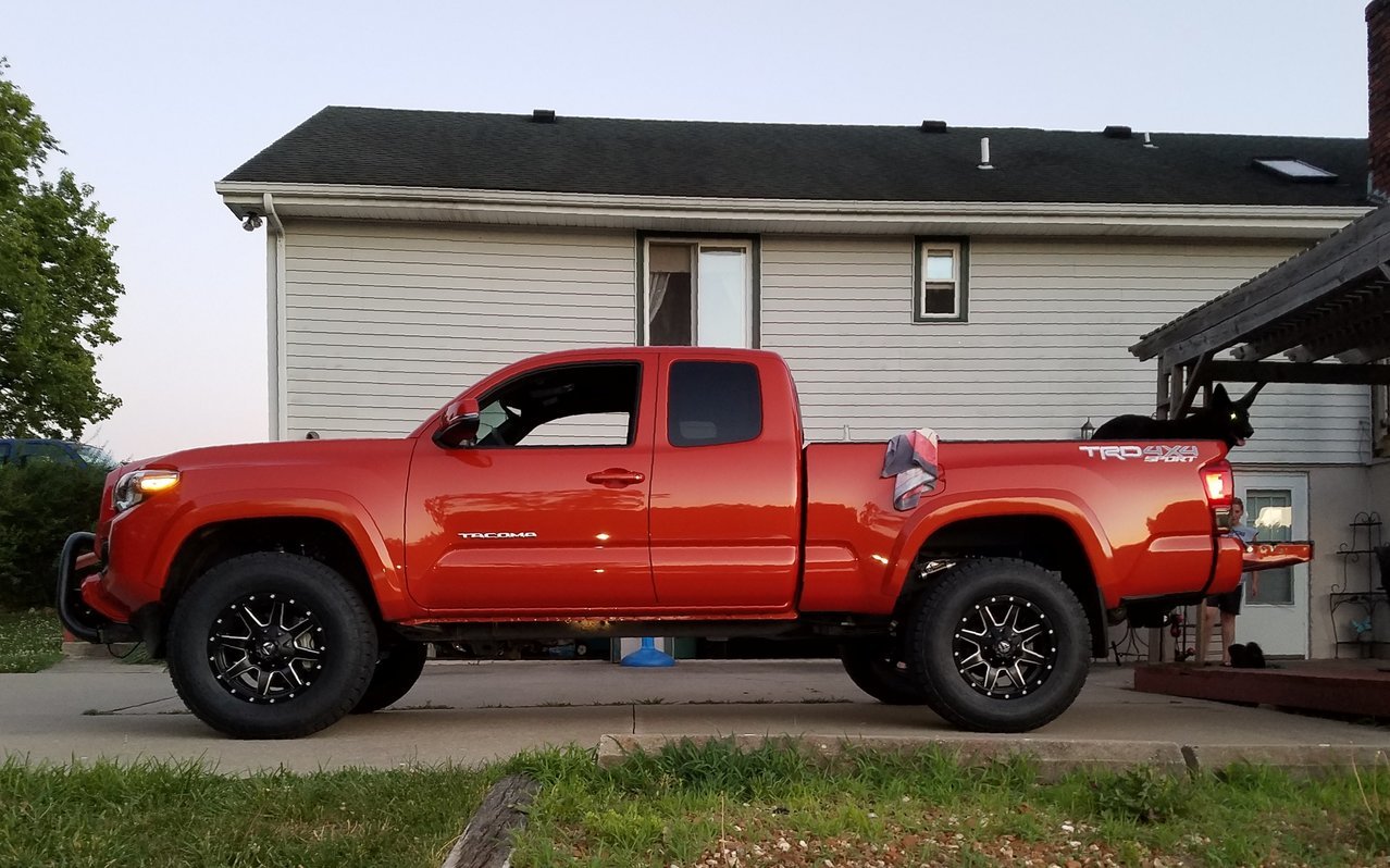

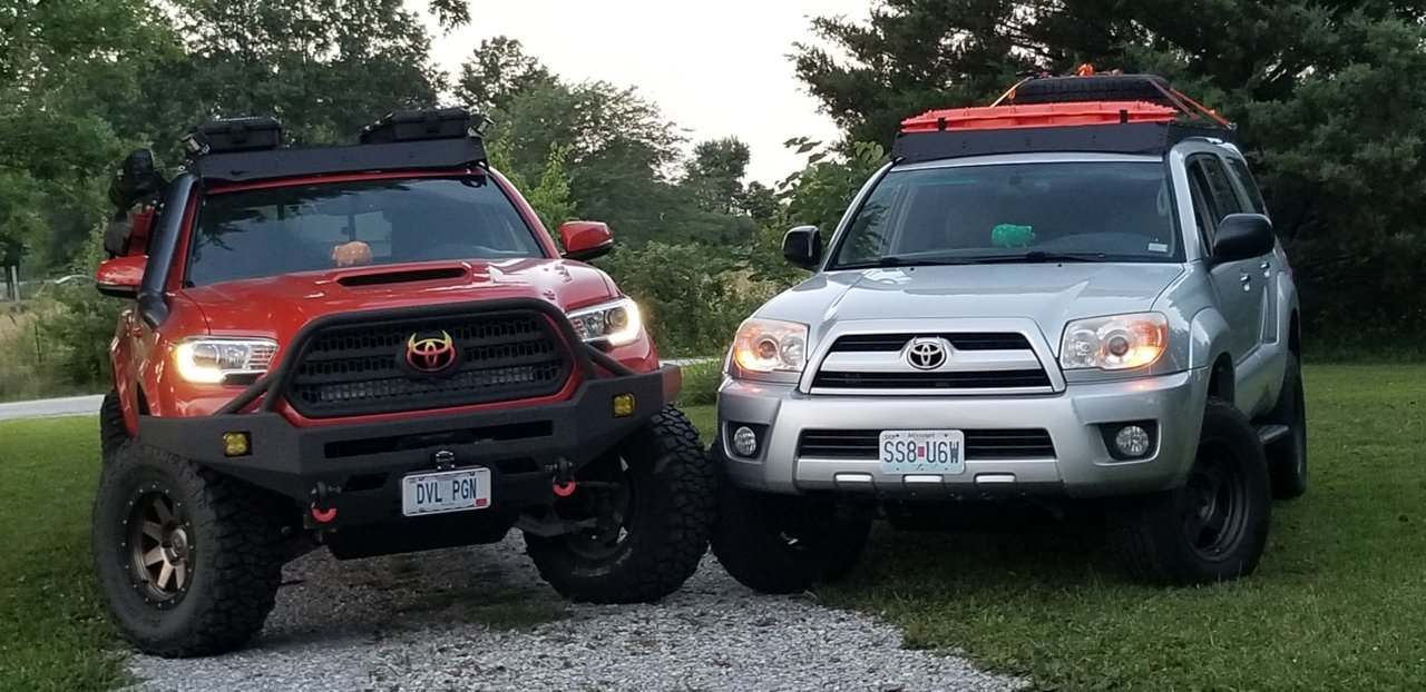

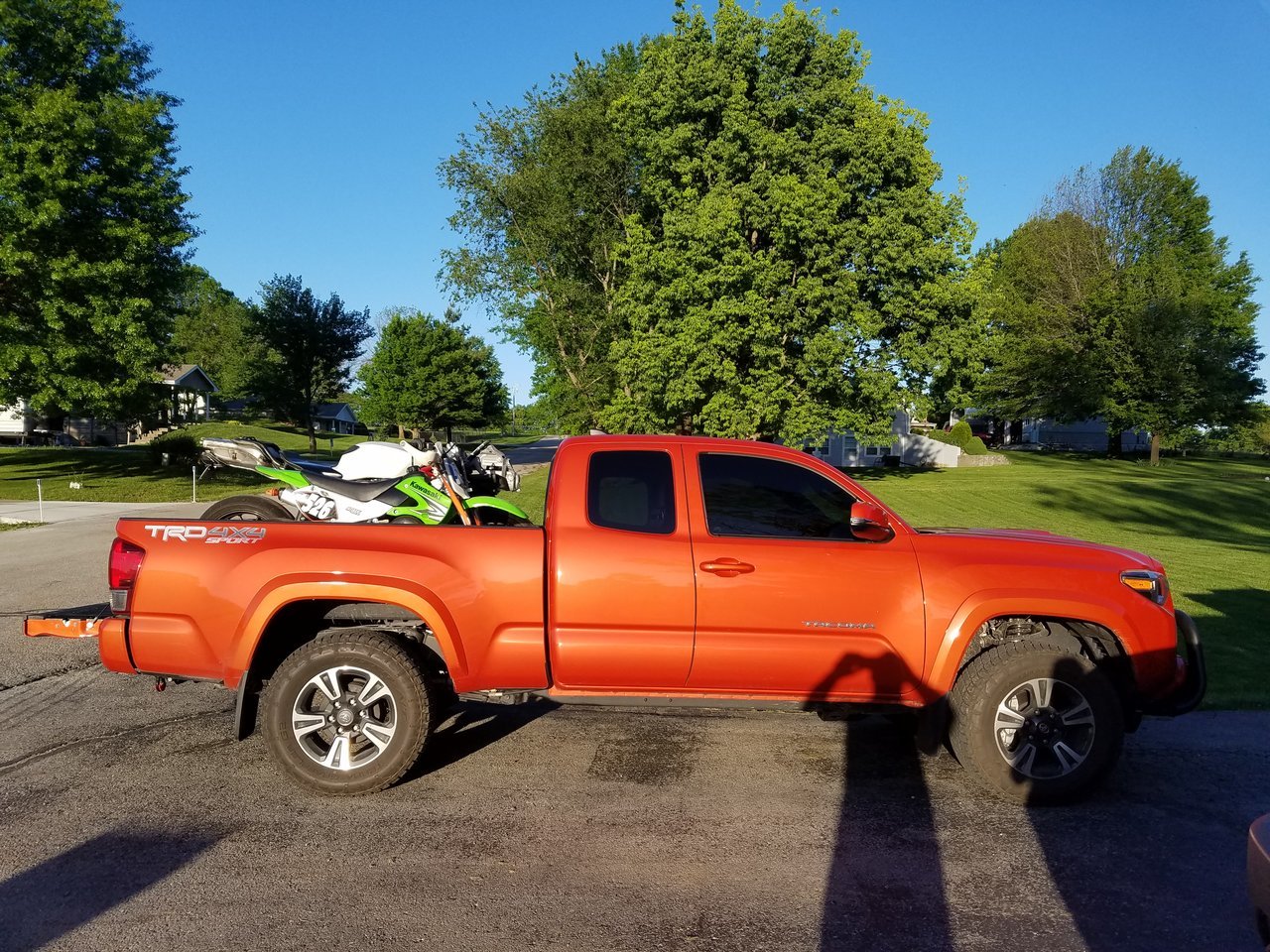

    So.....here's a few more pics to give you and idea of where we have come from....
    Stock but with better tires.....
    Then the Icons and Fuels with 285's
    Then came the Stealth 6's, I would have stayed with these had I not be
    contacted on the SR8's.....
    Yep. That was the first unicorn......

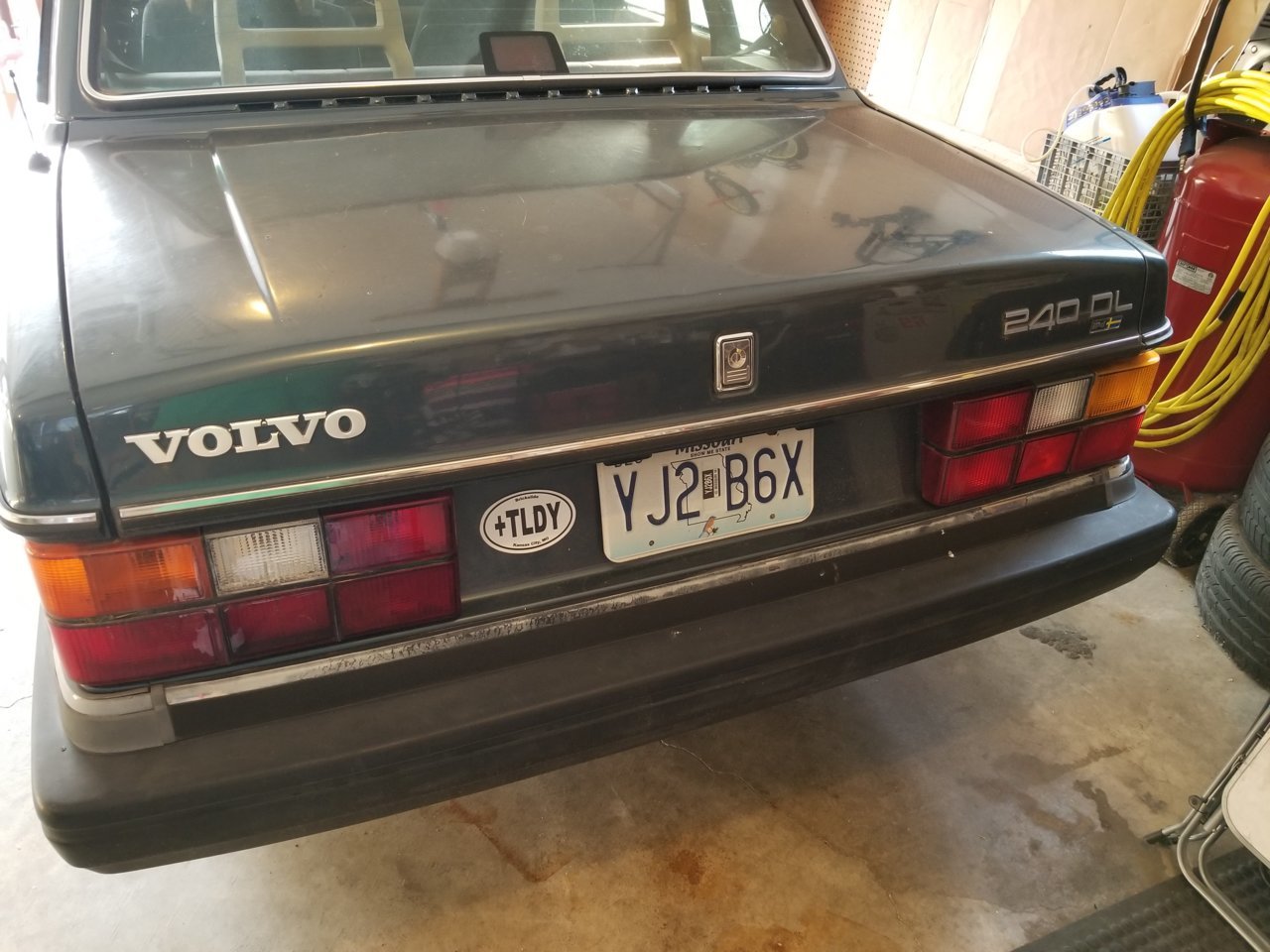

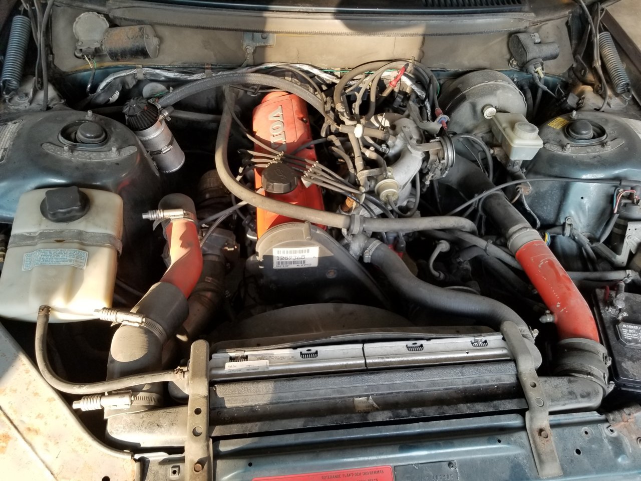

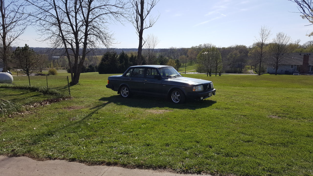

    And the other projects. The Tealady.
    Currently has the 8v Redblock that's boosted with a 940 manifold and a
    16T turbocharger.
    We bought at least 3 of the 16v heads with the intention of converting this
    one but after everything J went through to get one in the race car.....I
    decided to forgo that and just install a new drivetrain.....
    Probably swap a F-body drivetrain in with an 8" toyota for the rear axle.
    T56 of course.......

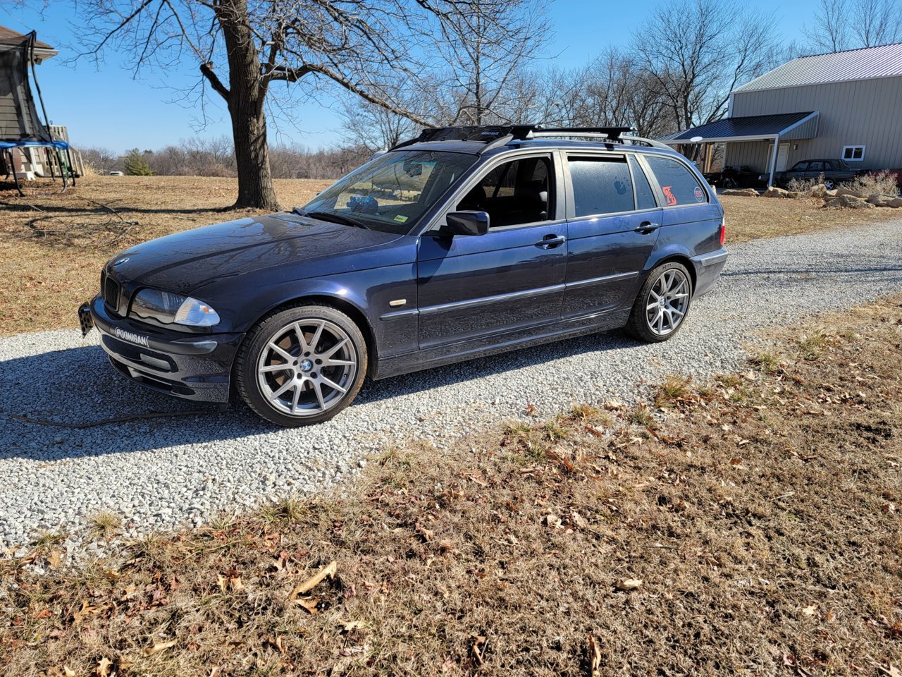

    And the e46, or V4 Penguin.
    This one really needs an M3 swap.

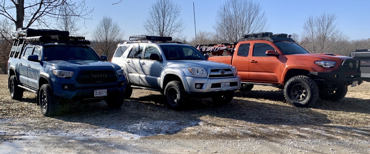

    A trio of sports......DP started that way....
