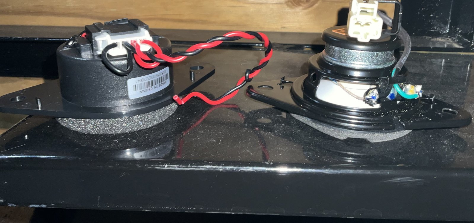

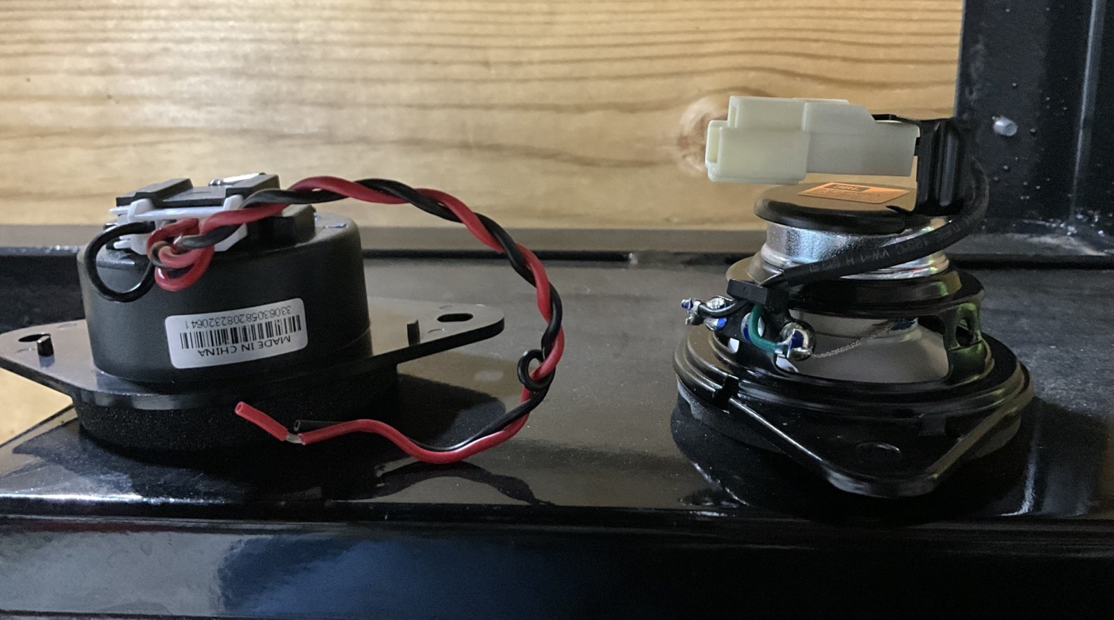

    I have a 23 dbl cab with the amplified JBL system and one of the first mods I wanna do is replace the speakers. My tweeters came in first so I decided to tackle this project. However, the connections are different than what I’ve been seeing on YouTube.
    I bought the DS 18 assuming they would be plug n play, but the connectors from the truck are different…. Looking for professional advice for an amateur…
    probably leaning towrds this and adding spade connectors on the DS18

    welcome to the joys of the jbl system.
    absolutely everything is different, more complex, and more expensive about it.
    the standard audio system consists of the head unit wired directly to the rear speakers, as well as wired to the front tweeters, which then go to the front door speakers via the 4-pin plug on the tweeter. that is where the plug on the ds18's is designed to be plug-n-play for.
    the jbl system consists of a head unit that talks to an amplifier mounted behind the rear seat via a digitally-encoded coaxial audio signal. from the amp, each speaker is has an individual set of wires coming off of the amp going to the speakers. all of the speakers are also a specialty 2 ohm variation, meaning that installing a car-audio-typical 4-ohm speaker will likely result in some volume loss due to the increased resistance. the amp runs a specific eq designed around the speakers included with the truck, making alterations to the system possible, but limited in capability.
