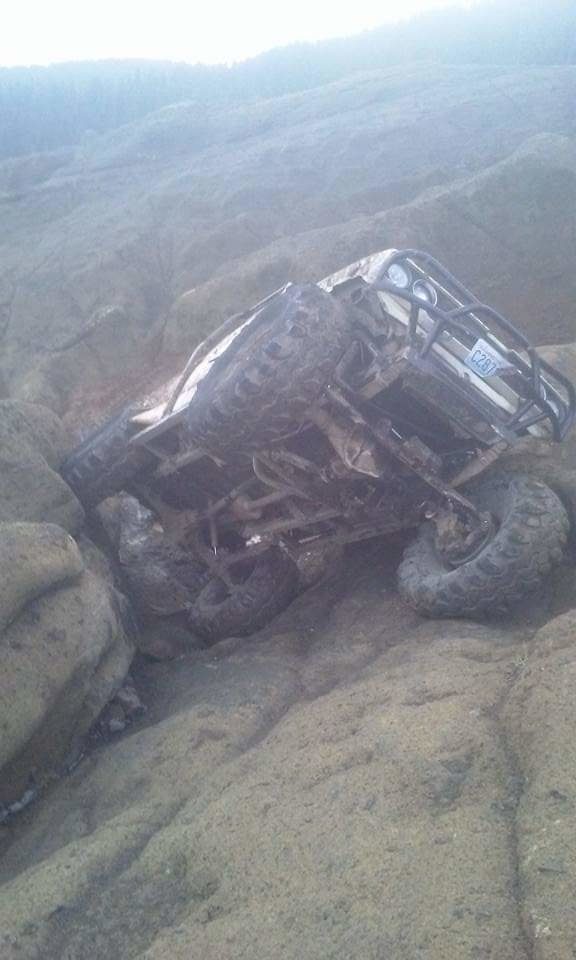

    Ran both dual 2.28s, and a single 4.7 case for years with 4.10s and 40s-42s. Worked just fine with a little 2rz.
    Still was able to idle/power through enough in stuff like this to blow the tcase apart a handful of times, break leafs, shafts, etc.

    Yeah, 4.10’s, 42’s and 21 spline was a recipe for failure. Not to mention the guys that would hard mount the cases.

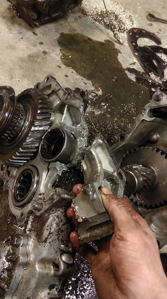

    I was 23 spline/chromo output etc, so the case itself was the weak point. Would just crack cases like so :rofl:

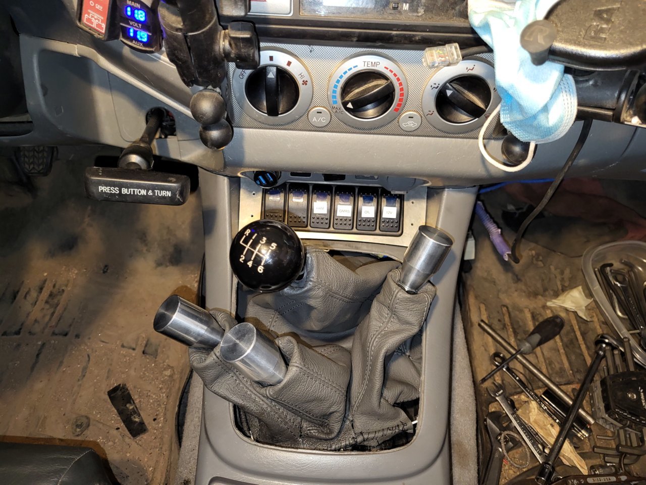

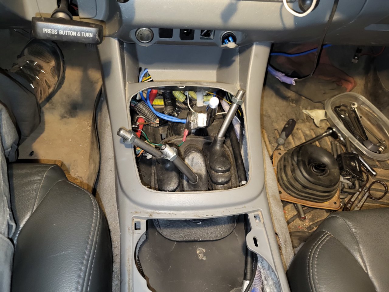

    The NWF setup is absolutely tits if thats your goal. They offer a triple stick setup that is very solid, but you are cutting a larger hole in your floor no matter what, so go ahead and accept that fact. I also enlarged the opening for the stock location on my plastic console by about 1" on all sides, but got everything to fit more or less the way I wanted. This isn't final, but basically where things landed. Final position, all of the sticks are a little bit further back than pictured below.
