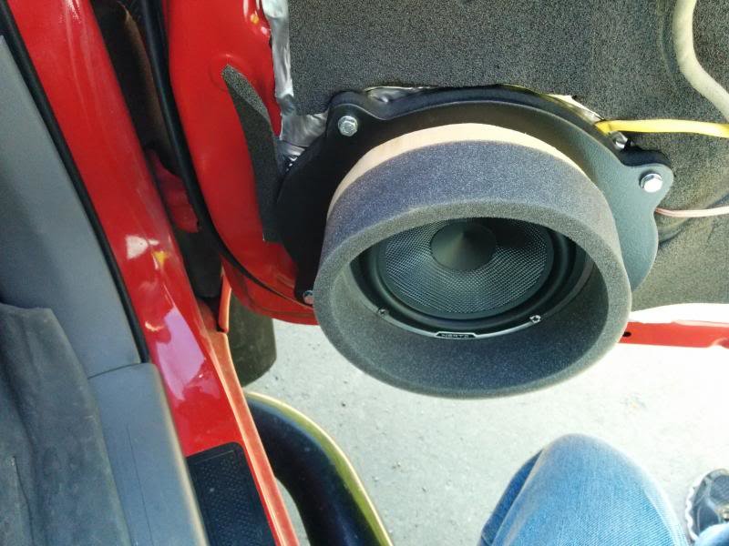

    It has to do with how I sealed up the doors. I used a corrugated plastic sign, like a "Garage Sale" sign, to seal the big holes, then, covered it with deadener and Ensolite. I think the cardboard is flexing, and I'm losing midbass and mid energy.
    How has everyone else sealed their doors? I was thinking a sheet of 1/2" birch ply with 3/4" self tapping screws and some silicone sealant to get the job done. Anyone with another suggestion?

    I don't think that has much to do with it, really. I "sealed" my doors with multiple layers of dynamat. I'm sure that's flexing but not enough to actually make a difference. Keep in mind that just because you covered up all of the visible holes, doesn't mean that your doors are actually sealed. There's plenty of spaces where air escapes and re-enters the doors while your speakers play and you want to keep it that way (or your doors will hold water when it rains).
    I think the mid-bass loss is just a product of our doors and the speaker location. On an RTA I've noticed substantial drops in the 500hz range from systems in our trucks. Next time I fool around with my EQ I'll post a picture of what adjustments I've made to help remedy that, but I'd look at it with a grain of salt since our systems are still quite different. Have you tried the foam seal between your speaker baffle and the door panel yet?

    I'm not rockin' the JL's anymore. I've got a set of Hertz HSK165XL's now. I checked on what Shane mentioned, about a dropoff in the 500Hz area. I boosted my EQ there, and got a noticeable improvement in the sound. Looks like more tuning for me, and my rings might arrive today as well.

    So, I installed the rings today. The back plug, about 6" in diameter, doesn't line up perfectly behind the driver, because of the safety bar in the door, so I'm not sure how much that affects performance, but they do make a difference. I was able to drop the 100Hz, 315Hz, and 500Hz ranges by 3db on the EQ, and the sound is crisper, more defined. The mids are more punchy, and really get to work at higher volume levels. I'll put pics up later in my build log, but I would say the F.A.S.T. rings from Soundconnections.com are worth the $25 to get that little extra out of your system, to improve the mid and midbass frequencies. Thanks Aw9d for getting them for me here in Canada, as shipping to Canada from soundconnections is cost prohibitive to Canada. I'm a happy camper.

    Flip the phase on your left midbass speaker. Re-tune the time alignment afterward with the phase flipped. Tell me if that doesn't fix your problem. It just might.

    When I'm tuning I typically try it both ways and see which one sounds more full. Sometimes the right one out of phase works too; just depends on the car. Most of the time the left one works better if putting one out will help. If you have to throw the mid out of phase you'll need to do some time alignment to get the stage back because it's likely to sound quite funny if you keep it normal.
    More often than not, lack of midbass usually means one of two things...
    1) Your midbass drivers suck or...
    2) You have a frequency cancellation happening due to some odd geometry in your car.
    #1 is an easy fix and #2 is a bit harder. You need to change some things.
    Those mids should be fine so I'm thinking option 2 in your case. It could also be worth building up some sort of shroud for the driver to act as a sort of "wave guide" that directs the speaker waves through the holes int door grill. If not, you can get some cancellations INSIDE the door covering. This is how mine are setup.

    That's what I installed today. The F.A.S.T. rings surround the speaker, and seal it to the door card. This puts the speaker output straight out of the grill in the door, giving a fuller sound. I'm going to try the way I have it right now, and see what I think at different volume levels, low level and high level have increased presence so far, and go from there. Here's a pic of how the F.A.S.T. ring seals to the door card.
