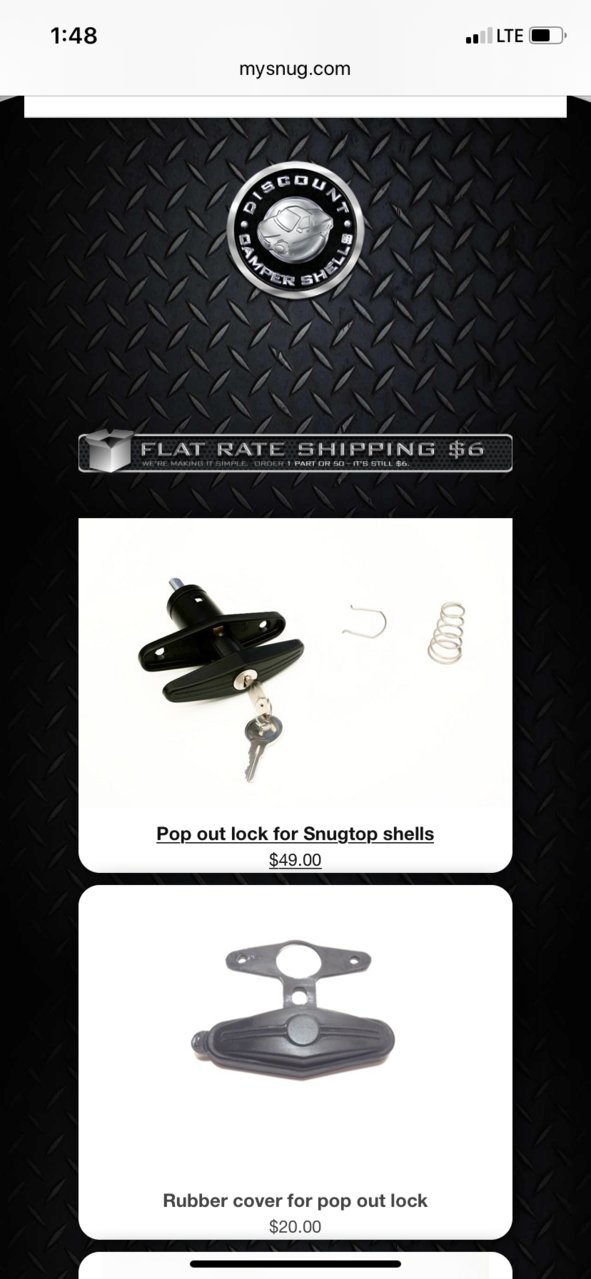

    Trying to get information about changing out the key locking mechanism for a pop out T handle on my snugtop camper shell.

  2. Oct 3, 2020 at 1:50 PM
    Parkvisitor
    Parkvisitor Do you know midnight?
    May 27, 2019
    #294502
    2,283
    Juan
    So Cal
    It’s a truck
    stuff
    Discount camper shells
    They’re in Long Beach California

    Thanks! I haven't been able to get a price nor answer from snugtop so this helps. I think that if the end shaft is different, I can jury rig it.....any one experienced the same swap out?
