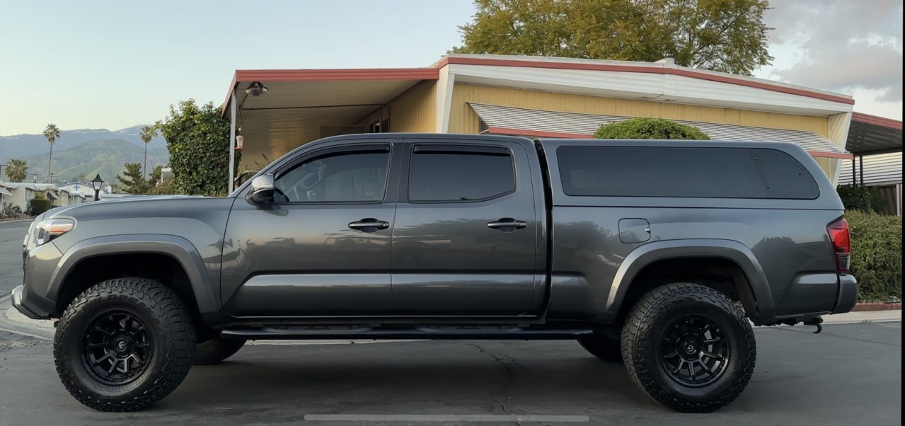

    FE682E88-A291-4173-8CB4-0B2BCA9A9A2A.jpg E9B6F77F-ECC6-45EF-AB9A-378777EED451.jpg I heard a long time ago from my friend that owns a body shop. Truck tops always leak. Well I firgured that was for cheap ones. I bought a $3,400 snug top super sport (not exactly cheap) and it leaked bad from the start. Car wash, rain , hose , whatever. I didn’t want to go back to the installer because of other headaches I’ve had with them since day one also ( I have a separate thread regarding NORCO CAMPER in norco ca)
    I finally fixed it myself by placing a bead of clear silicone around the entire perimeter of the exterior windows, which stopped the massive leaking completely. But now to my issue…
    One after 9 months my gas shocks on the rear window gave out and I was using a stick to hold it open. I went and took it back and they replaced the shocks free of charge. Although they told me they don’t have time to install it, but they could show me how it wasn’t hard, but that’s beside the point. Now here we are a year and a half later, and the shocks are failing again I rarely open the back I close it properly with care, so I guess my question is what is the best brand of gas shocks for my snug top rear window. They are master lift that keep failing. I’m sure there’s a thread on it but I figure I’d include the title headache because for this much money it seems like there’s a Lotta issues that need address for something that cost this much.

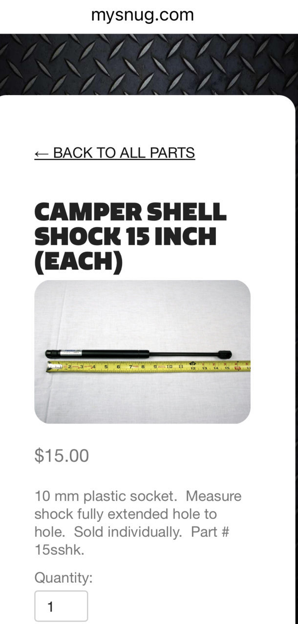

    In the past, I've looked on those struts in various uses, found a part number and performed a search. Try a different brand maybe?

    the gas shocks are something that wears normally and needs to be replaced. I would get the part number
    off the shocks you have and cross reference in a different brand. Important to install properly the shaft must
    be down with the door closed. other wise they leak gas quickly.

    https://www.liftsupportsdepot.com/
    I've been using them for as long time. Everything I get form them has been the Strong Arm brand.
    You'll have to cross reference with a part number or dimensions.

    this is what I bought and they seem to work well . https://www.amazon.com/gp/product/B07PPPTW3J?ie=UTF8

    I have used Suspa & Nitrolift brands with good results

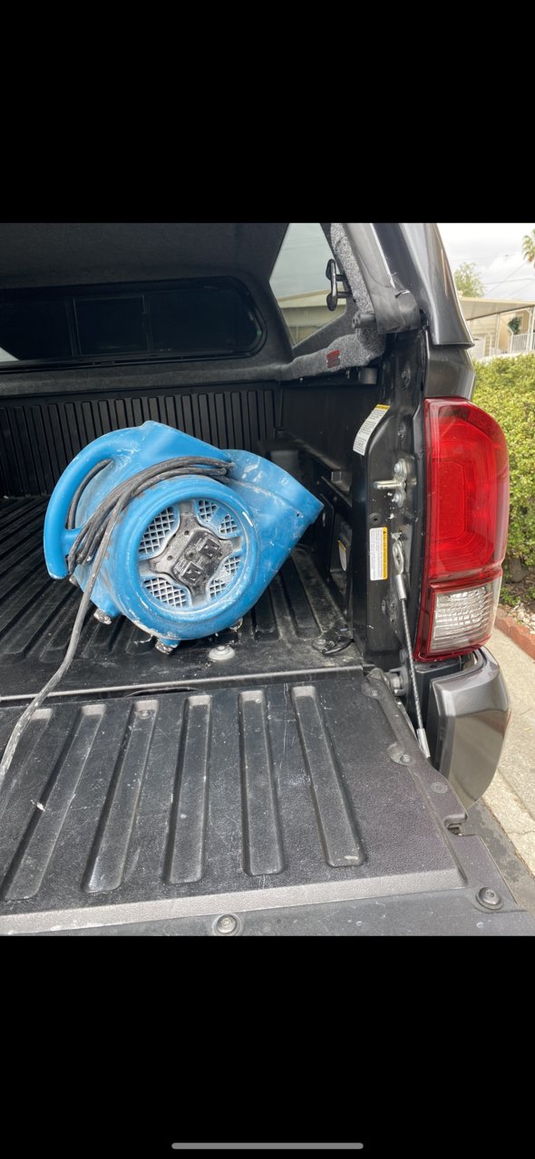

    Ya that video with that guy,,, damn I thought I was the only one. That’s such BS for the amount we pay for a brand new top. Here’s me one week later when he said I could wash it 3D8A24C9-78D7-4686-BA62-A9D986DD6300.jpg
