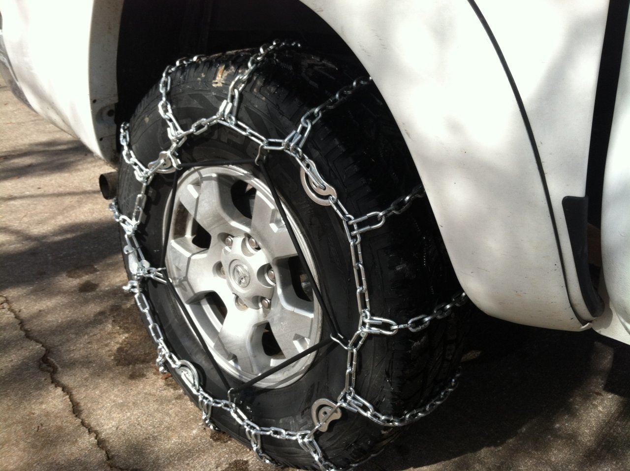

    Unless you're truck is lifted you may have problems making chains fit. Especially with E rated tires. At any rate it is going to be a close fit.
    I bought these in the 5.5mm size.
    https://www.tirechain.com/Tire-Chains-Square-Alloy.htm
    They work a little better in close fit applications, yet are still mud rated. I can't make them work on the front.
    Your chains need to fit TIGHT against the tire, or you'll get body damage.
    On my Tacoma
