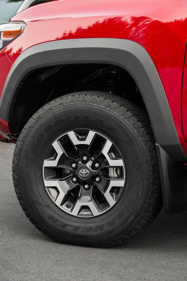

    I need to buy some snow chains, as they are required to be carried for the mountain pass drive I'm going to be be taking this weekend, and I know nothing about what to get - hoping you nice people can help me out! I have a 2017 Toyota 4x4 Off-Road with stock wheels and 265/70R16 tires (also what came with the vehicle). Same wheels and tires as the attached picture.
    Will these work? They look "easy".... but I'm not sure if they will work with my wheels...

    I'm sure those will work. You may even want to go by a local tire shop and buy it from them. Then they can show you how to properly fit them on your truck. Improperly installing can do some serious damage to fenders, panels, etc.

    Good question. When I purchased my 2017 4x4 OR, the dealer had me sign a disclaimer form that stated that the truck couldn't be operated with tire chains and then referred me to the owner's manual. The owner's manual describes how to select, install, and drive with tire chains. I've asked several times at the dealer (Toyota of Poway), and they have never given me a satisfactory answer. My Tacoma currently has the same tires and wheels.

    If you did have to actually use them I'm guessing those front mud flaps would need to come off. Bring a snubby Phillips with you. 4 screws.

    Do not use in front. Use chains in the rear only. Put on tight and retighten after driving a short bit. Buy good chain tentioners. Keep your speed lower than normal. As said earlier a lot of damage can occur.

    With that tire size not all chains will have enough clearance. That is why Toyota, and most every truck manufacturer advises not using chains. You run the risk of the chains contacting sheet metal or suspension components. Some chains are designed for close fits, and the heavy duty V bars will not work on your truck with that size tire. A smaller tire will give you more clearance.
    Cables work fine for most people. Chains are better, but a 4X4 with cables is pretty capable.
