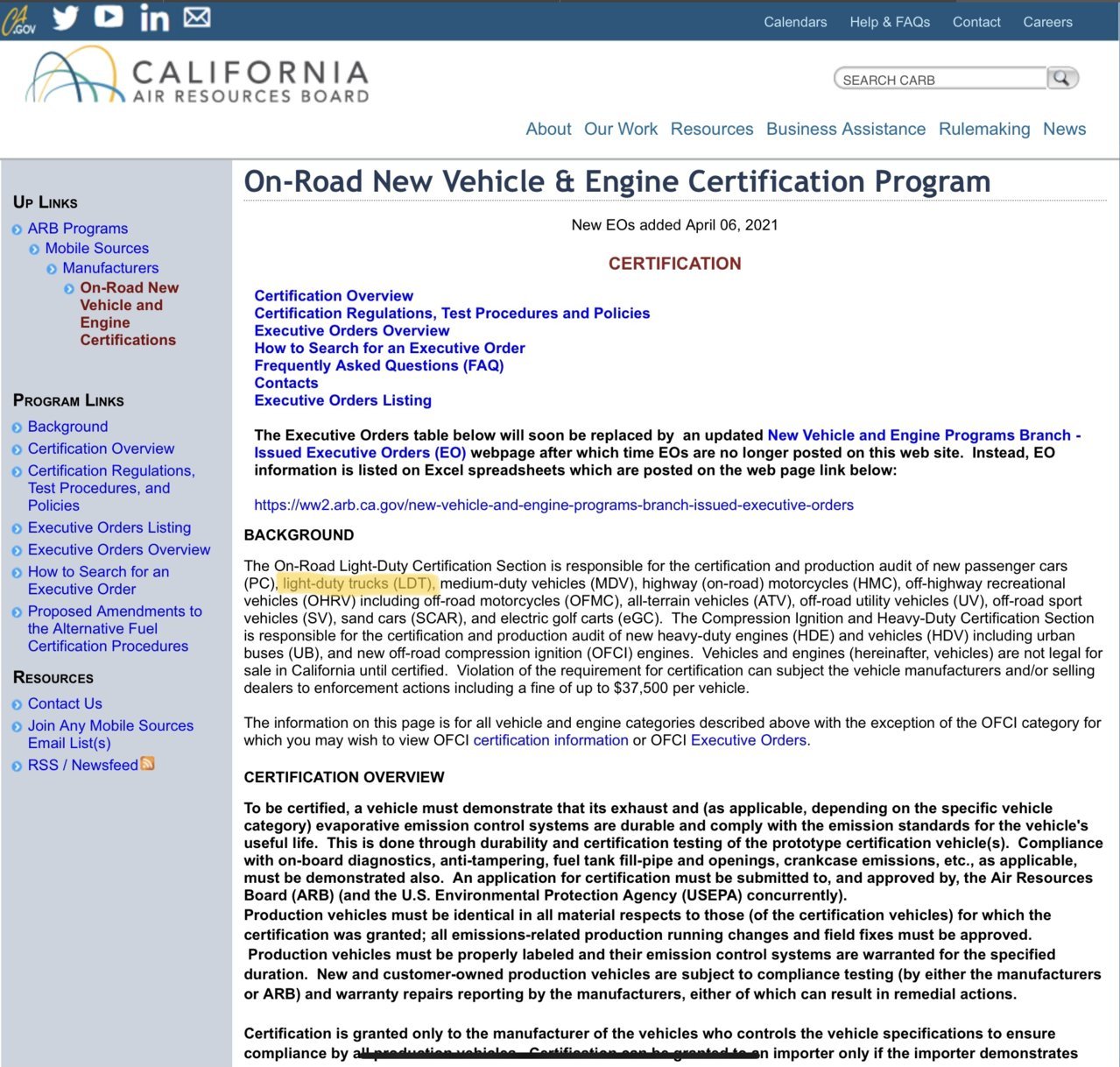

    Donor VATS
    1st gen Tacoma’s are a LDT on this list so donor engine must be a LDT and the Tacoma’s year or newer and larger displacement
    https://ww3.arb.ca.gov/msprog/onroad/cert/cert.php

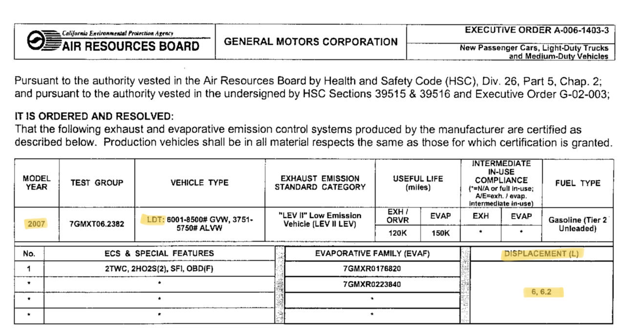

    That’s one thing I specifically asked the referee about
    There are plenty of 5.3s, but I’ll throw this out there - look at the attached pdf for reference vehicles
    all of the 5.3s that match the light duty truck LDT are 2007 and newer
