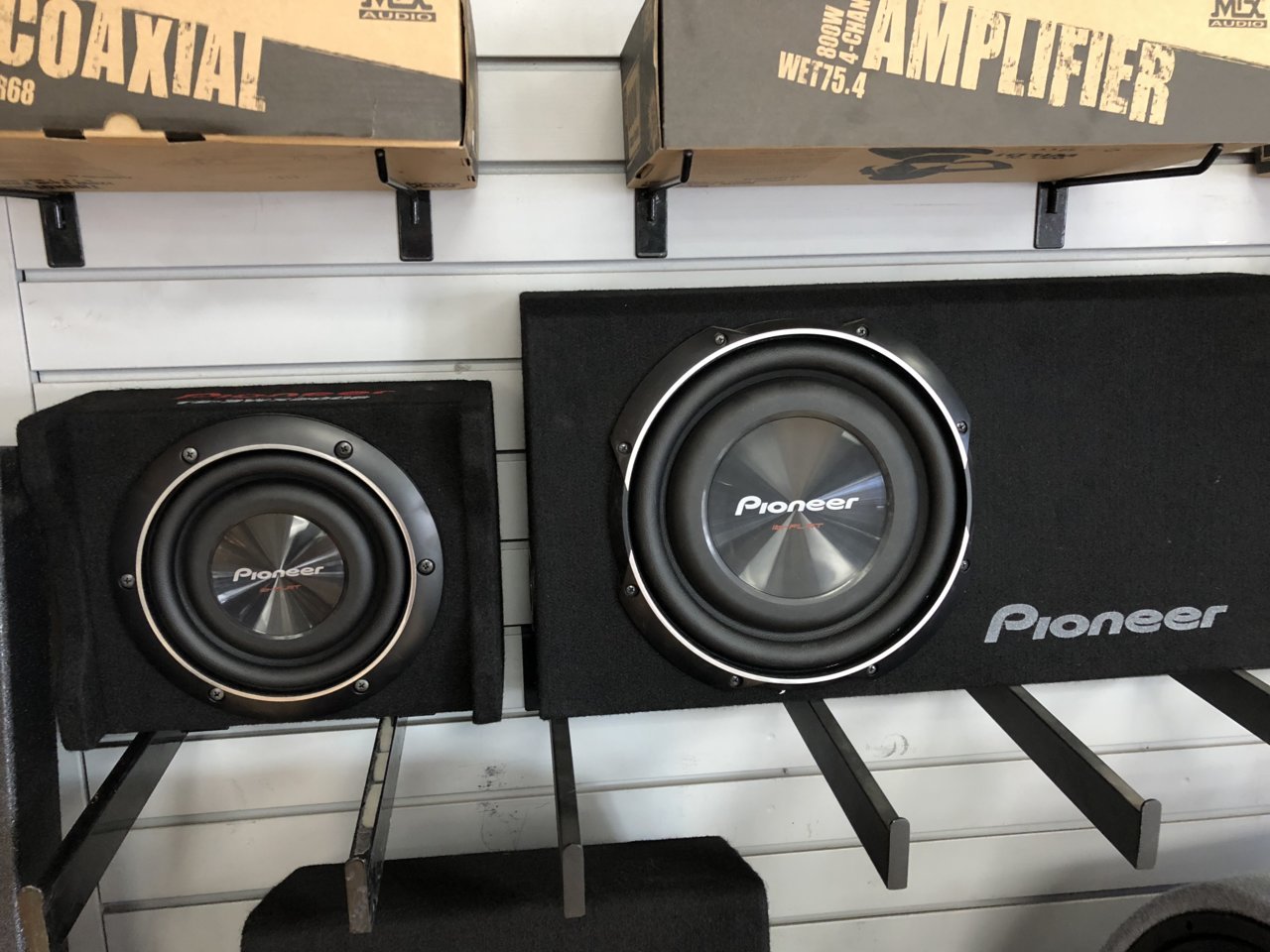

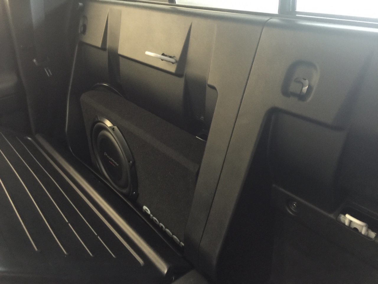

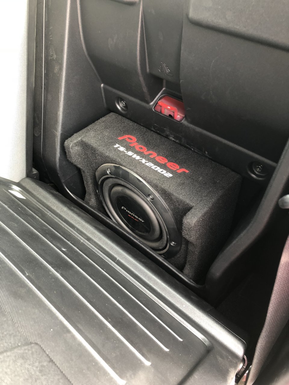

    It fits!
    The seat folds back and latches no problem too. The speaker sits a little close to the lip of the bin, but I’ll probably either aim it towards the back of the cab, add a grill, or trim the lip.
    If one were so inclined I’m pretty sure you could actually get 3 of these behind the seats... No music impressions yet, I was able to find and test fit this one at a local shop but I have a few more thinks to work out before I purchase.
    These boxes are tiny btw, the box on the right is the Pioneer UD-SW250T for their shallow 10” (that also fits behind the passenger seat) and the left is the 8”.

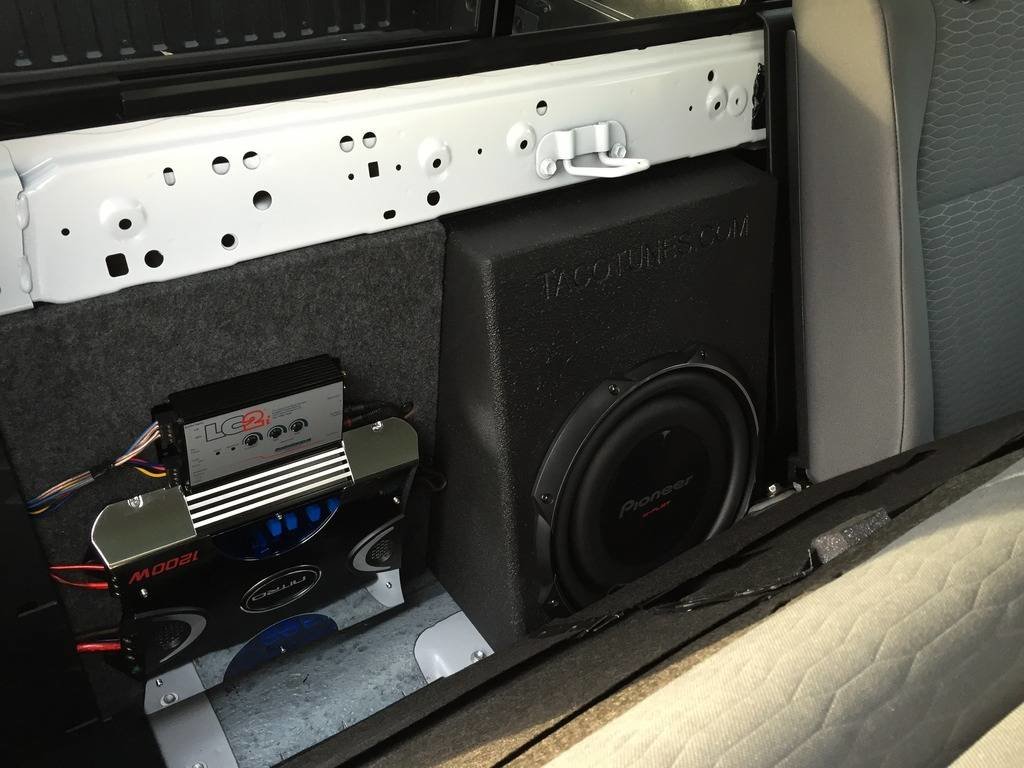

    I went with the pioneer set up that quite a few folks recommended and it worked like a champ and was a MASSIVE improvement. I can feel teh difference in bass and even though I wont be winning any competitions with this mini beast, it is still worth the upgrade. I also bought new Door speakers and are going to install them soon. I will post pics once complete!

    Here's the sub I put in my son's Tacoma 2 years back. He's upgraded to a Rockford Fosgate 500w amp and it thumps pretty good.
