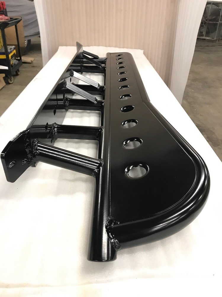

    We run a few trucks with and without fill plates. From purely a function standpoint, I've noticed that fill plates are either beneficial or not based on the user. For instance, I have a size 12 shoe, and that shoe to too big to really get any of it on the fill plates to make a difference, I end up always standing on the outer tube. Now my 2 year old, or wife with heals on, or my dog, they sure like fill plates because of smaller shoes... or paws, especially sliders with a kicker.
    I don't feel they collect any more debris that sliders without fill plates. All our trails here on the east coast are mud covered, and really the legs are going to get covered the most, so if you are already spraying out the body's rocker panels and slider legs, its really no additional work to spray the bottom of the fill plates also.
    For a fill plate design, dimple dies look great, we make the down and up based on what the user wants. Dimple down looks really good to me, my brother like his up, but dimple die up does provide a grip surface. Diamond plate is really the best for a grip surface as the are more bitting edges that dimple die up could provide. Really there are a lot of options out there, and you can't go wrong with any good frame mounted slider.
    Here's some of those fill plate designs we make for reference.
    Dimple Die Down
    Dimple Die Up
