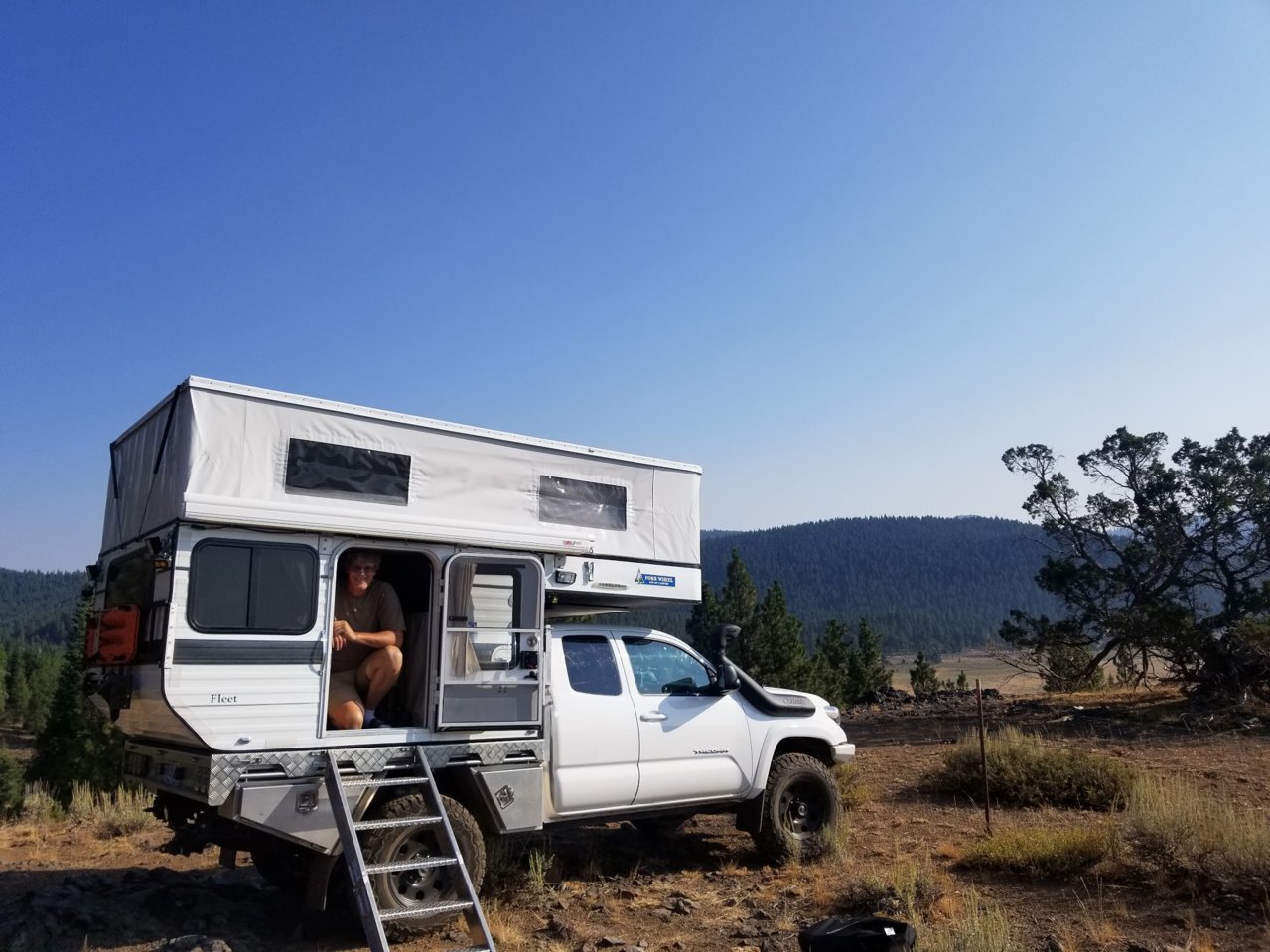

    Pretty sure Base Kimbo is the lightest. May not be the best for your application though, and the FWC comes standard with more equipment which if added to the Kimbo would raise the weight.

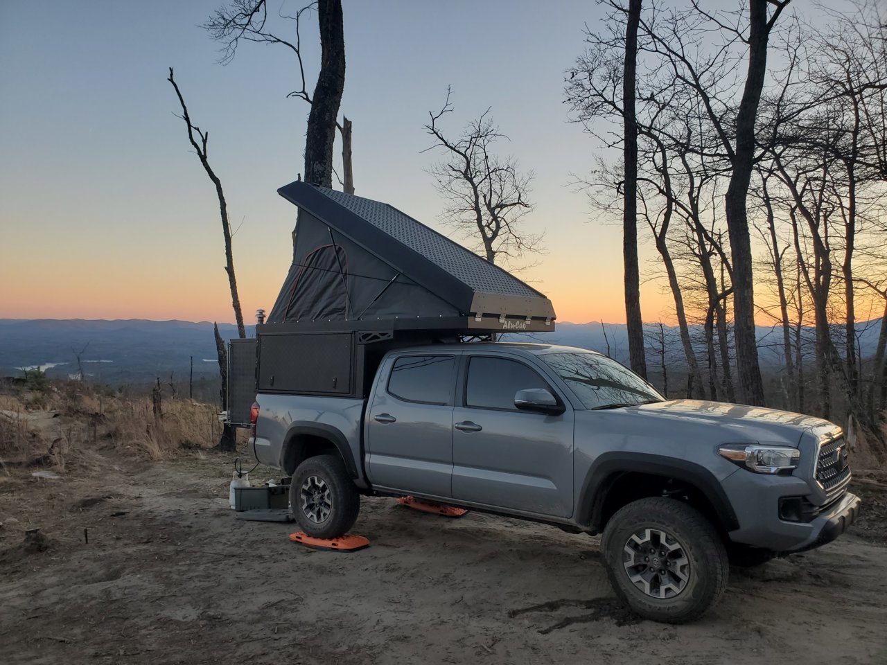

    Lightest would probably be the alucab canopy camper, also as an Alu Cab owner I may be biased but the Canopy Camper and Khaya are in a different league all together than the FWC, the FWC is more spacious but for off road and hard use the Alu Cab stuff is much more rugged. Yes I’ve used them all, even had one of the very first GFC’s there’s always a trade off. It’s just what is most important to you.

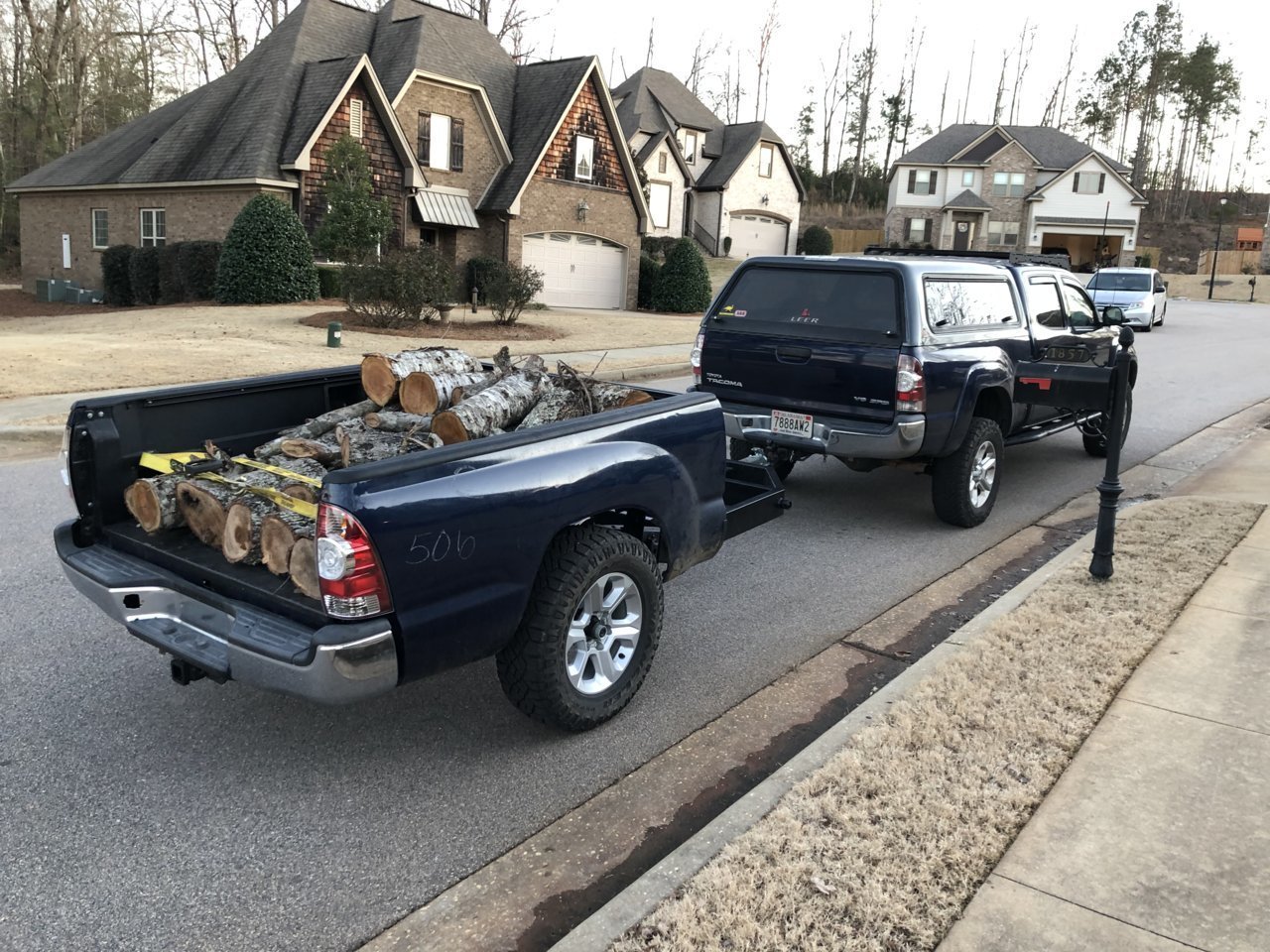

    gixxerphil
    gixxerphil @concretelander
    Mar 31, 2018
    #249012
    22,673
    Phillip
    Auburn, Alabama
    2013 DCLB
  5. Apr 4, 2021 at 10:37 PM
    #25
    gixxerphil
    Mar 31, 2018
    #249012
    22,673
    Phillip
    Auburn, Alabama
    2013 DCLB

    gixxerphil
    Mar 31, 2018
    #249012
    22,673
    Phillip
    Auburn, Alabama
    2013 DCLB
    If I'm not mistaken, one or both of those guys weighed their rigs......or maybe I'm just making that up in my mind :rofl: Either way, they both have first hand experience with something like you want. It's not I had a 1970 something with 44 tires in the bed without a problem, or you'll bust into flames if you add 3 extra lbs type of thing.

    Or you could just build a trailer out of your bed :rofl:

    I picked up a bed rack the other day, RTT should be here Friday, and a buddy is hooking me up with a tailgate at the end of the month. Should be a decent little camp trailer.……reasonably priced too. I also think it's funny as hell pulling it down the road :rofl:

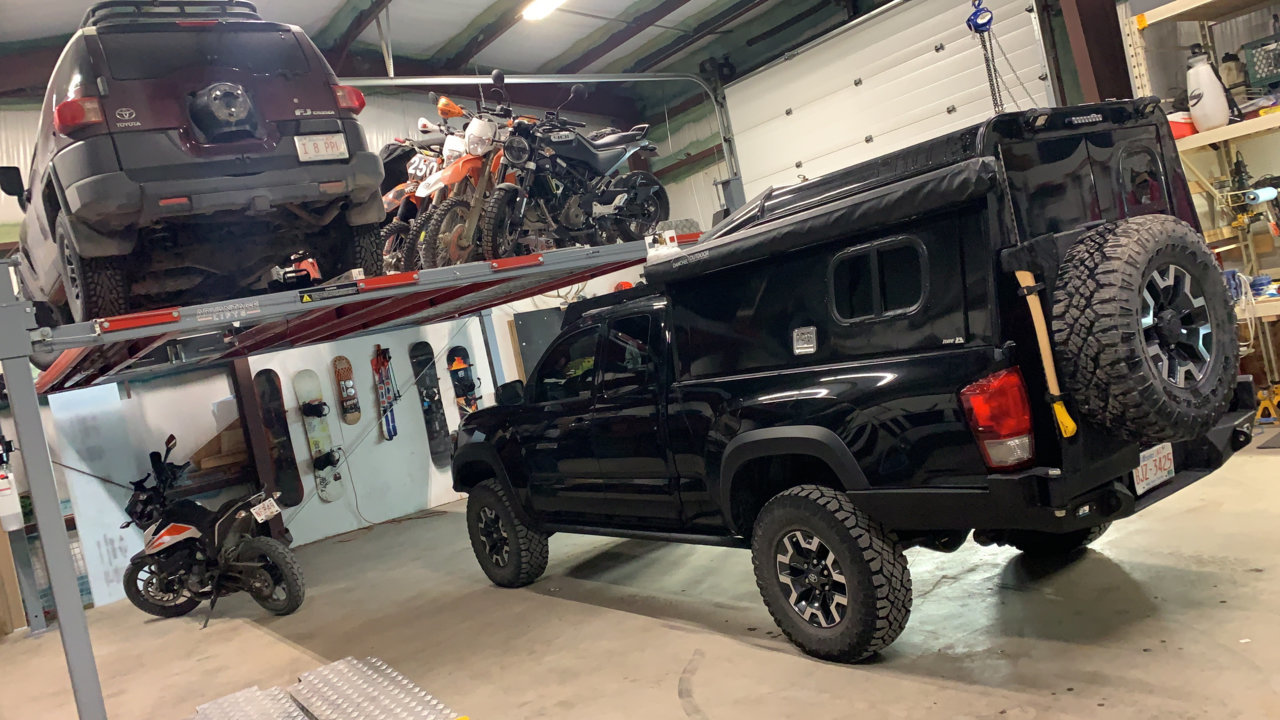

    #32
    bodean
    bodean Well-Known Member
    Apr 3, 2016
    #183240
    897
    Shawn
    Crowsnest Pass, AB
    02 Taco RCSB, 16 Taco AC6MT, 07 FJC, 22 Bronco
    Bumpers, skids, sliders, gear, gas and 2 people, right around 6000lbs at the scale. I can't see how anyone with a similar setup wouldn't be over the GVRW.
    Definitely well over hauling the bike around. Still handled fine, cruised at 110km/h with no issues through the mountains and still averaged 14L/100kms

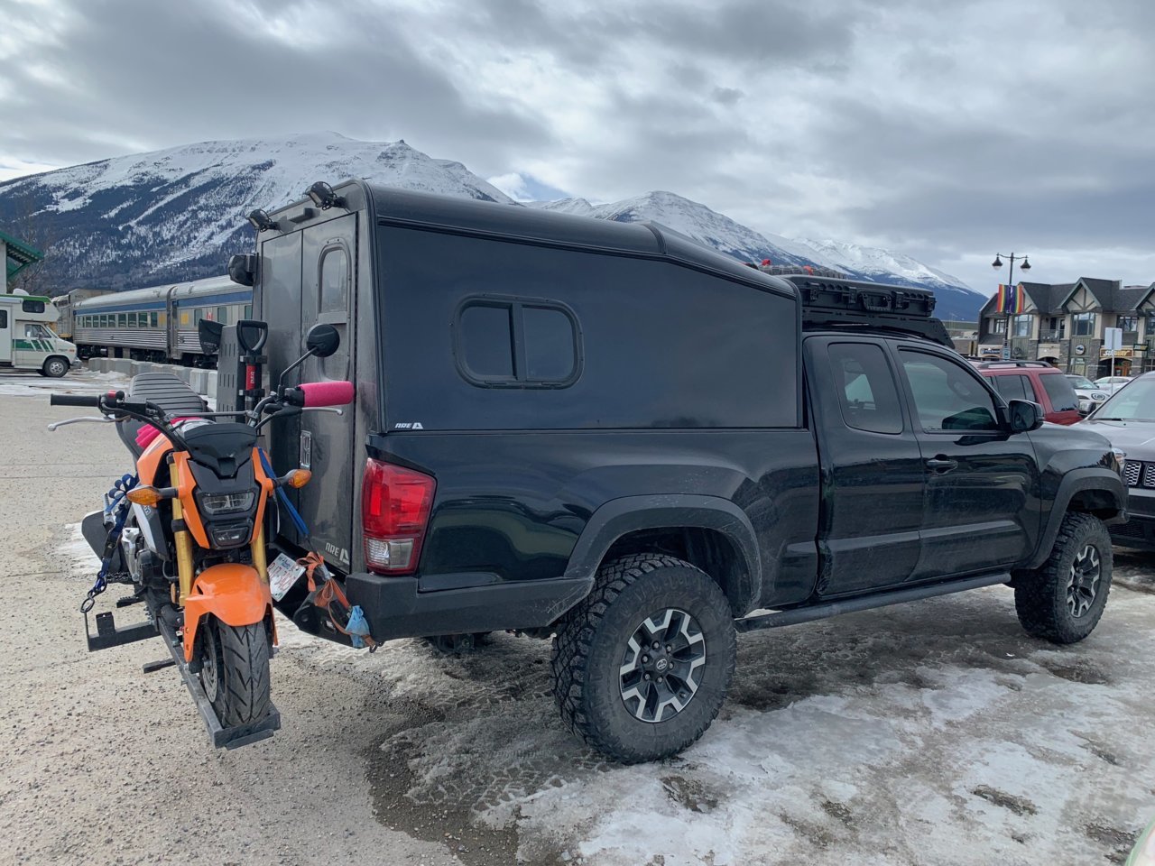

    #38
    honkonbobo
    honkonbobo Well-Known Member
    Sep 5, 2018
    #265270
    926
    Eric
    SW Ontario
    2021 ACLB TRD OR 6MT
    i just sold a FWC that i had on a 2013 ACLB. it was an eagle shell model that said 530lbs on the nameplate but had solar with wiring, AGM battery, ARB awning, yakima tracks/bars and a bigger maxxair fan and weighed closer to 850lbs. thats still doable with Tacoma if you are packing light with 2 people and your base rig isn't armored.
    i loved the FWC and am really sad to see it go but i was having an issue with storing it when off the truck and honestly my truck was too armored to take that extra weight... plus i like to wheel and was concerned about wear and tear.
    my advice to anyone considering putting one on a Tacoma is find a lighter shell model and keep your gear and pack list light. in the same way we all accept our trucks aren't in the same power, towing, and braking league as the F250s, we also have to accept that a camper with absolutely every option on it is a camper we aren't going to be able to carry safely on our Tacoma. if you absolutely have to have all the options you will be better off starting with a bigger truck. edit: something exactly like the Bobcat @tacojoe1237 is selling is perfect.
    the go fast camper and vagabond type options look good too and are light but i think the FWC still rules for comfort to weight ratio. not only did i sleep great in the FWC... spend an afternoon on the couch in a FWC waiting out some rain with a book/movie and a coffee/beer and you will get it.

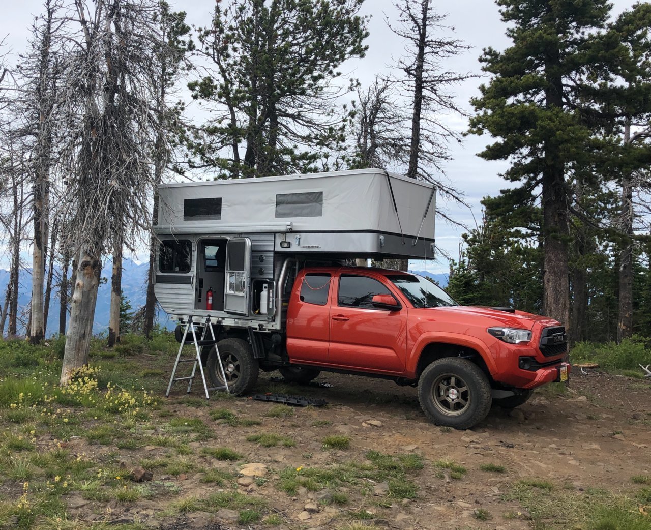

    @honkonbobo Totally agree. slide ins for a tacoma are not the best idea they are just too underpowered. The payload is also an issue. Also I was getting terrible gas mileage with mine on due to the wind resistance. I think if you could get an ATC custom made to not hang off the sides of the bed rails and have the cabover section as close to the cab as possible, it'd be a game changer. I sold my camper and now am on the hunt for a flip pac or tall shell.
