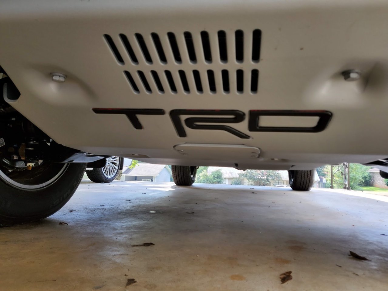

    20210907_160052.jpg I think all of them do. I know the OEM does.

    How much room does that little door give you? It looks pretty tight to me, but maybe it's all you need. Seems like they could have just as easily made it twice that size.

    No problem accessing the oil filter through the door. My experience when draining the oil is that some oil gets on top of the skid plate when you first remove the OEM plug. I bought a quick drain to solve that problem. The Fumoto valves are very popular too.
