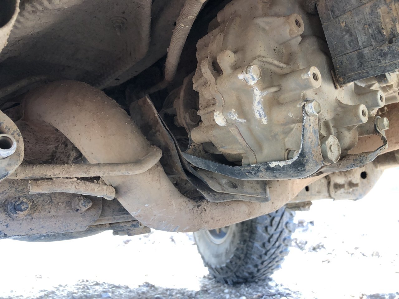

    I’m looking to replace my stock skids as well. Can’t decide on aluminum or steel. What do you guys recommend by looking at my current skids. And is that bend bolt going to be an issue?

    No. The nut that gets bolted into gets scrapped when installing aftermarket skids. As far as AL vs steel, I always recommend steel unless you're somewhere that heavily salts the roads AND you don't plan on wheeling too hard.

    Based on the amount of mud and scraping you have exhibited in this photo, I would recommend you purchase steel. Overall, steel will take abuse better but does require maintenance. It will slide over rocks better and not deform as easily.

    High centered on a rock today. Almost took out my transfer case.
