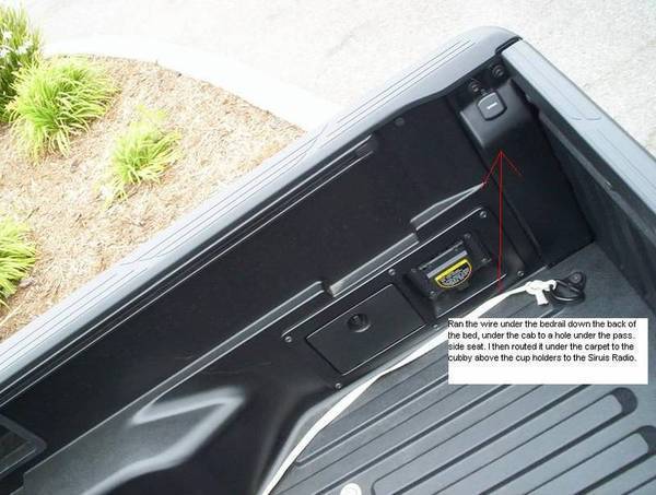

    I hate my antenna on the rooof, the dash sucks so I put it on the bed...
    Also I use an FM modulator and love it....real easy install I will post the master sheet when I find it (from crutchfield)
    here is a photo of my antenna placement (also in my photos)

    I actually installed the modulator yesterday - very easy to do. Got everything set up. But the attenna is on the roof. Does your plan include how you got your attena out in bed? Sweet location, but I couldn't figure out how you got the wire through the cab and into the bed. Is there a grommet somehwere?

    there is a rubber grommet under the carpet of the pass side front seat....if you remove the plastic door jam and lift up the carpet you can get your hand in there and feel the rubber....remove it and look under your truck and you will see where...I zip-tied the wire to the frame back to the bed then ran it up the back of the bed...there is a small gap between the top plastic and the rail, run it there.
