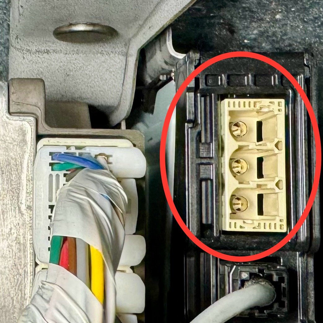

    After tearing apart my passenger dash (doc RM10000000188KM in TIS) by removing the scuff plate, cowl side trim board, instrument side panel, passenger knee airbag, glove compartment plate, and finally the glove box/"instrument lower panel assembly" with a trim tool, a philips, and a 10 mm socket I was able to see the DCM module on the far right with the three antenna connectors.
    Almond colored antenna connector block on top of DCM module
    Three factory FAKRA connectors

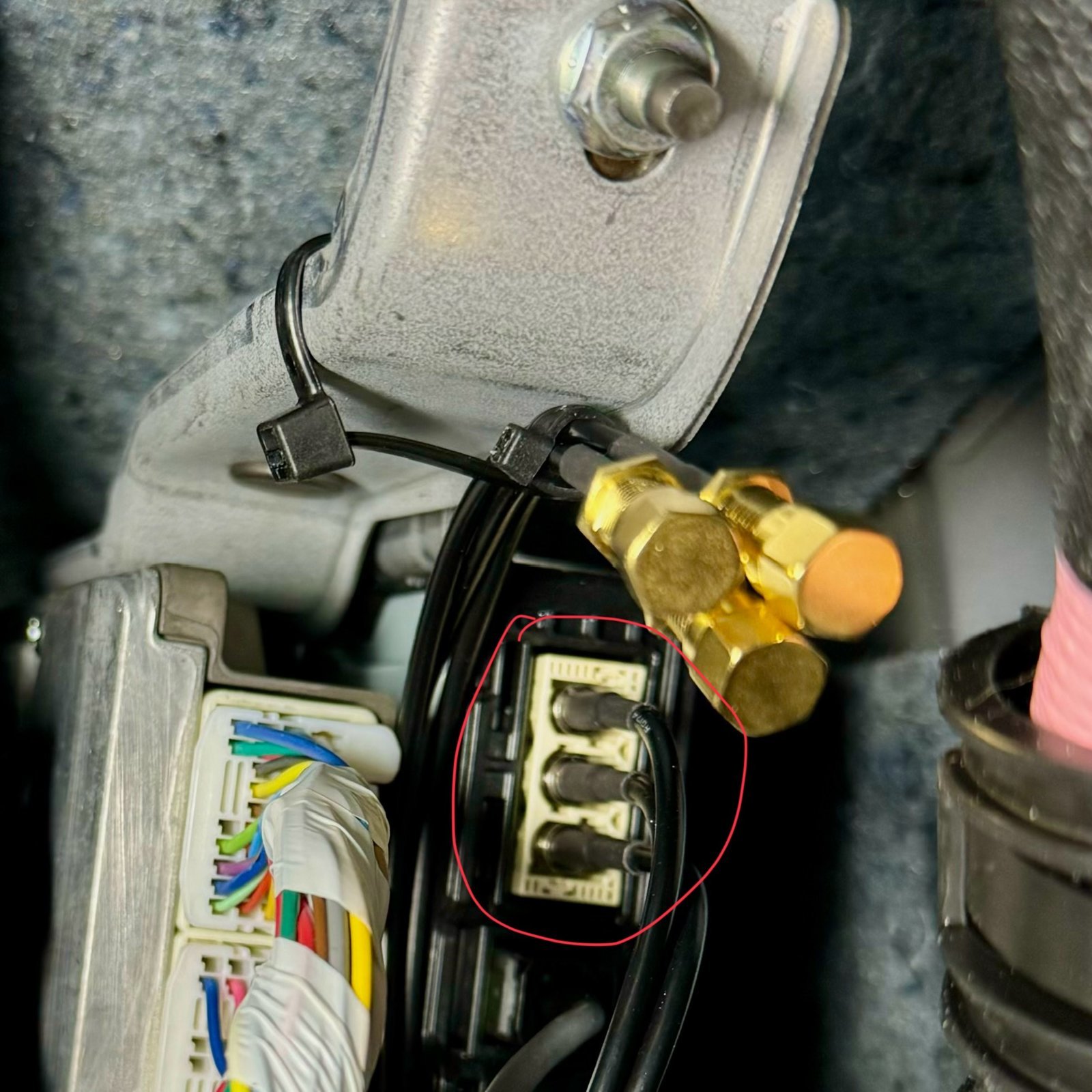

    Since the set of FAKRA-Z connectors from Amazon did have a backup spring that held the collet end of the connector with a bit of a "snap" onto the DCM module, I decided to just skip modifying the shells to fit the width and just strip the three connector bodies and attach the SMA terminators:
    These zip tied nicely into place with no real tension on the three DCM terminals:
    I did end up wrapping the bundle of SMA connectors with some adhesive-backed felt to keep any rattling down and added a few more zip ties on there for some additional support. All of the plastic bits got snapped back into place, knee air bag bolts re-torqued back to 10 NM per the specs in doc RM100000000VG05, and went for a test drive.
    Success. No check engine light, no warnings on the navigation system, just a red light next to the SOS button and a grey "no coverage" DCM icon in the upper right hand corner of the nav system.

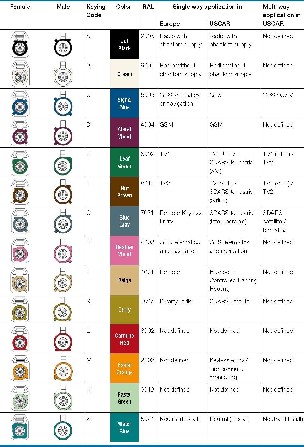

    So, according to the USCAR color codes:
    - The blue is for GPS
    - The grey is for ‘SDARS’ (?)
    - The cream (white) is for radio (?)
    Can you verify what the Toyota connectors are, and what you lose when you block each connection?

    The interesting thing I came across as I was researching this project is that the FAKRA connector colors are suggestions, not necessarily standards. The consistency between colors and connectors is the "clocking" of the little tabs around the barrel and their alphabetical designation (ex. Z is dark teal and doesn't have any alignment tabs, B is white or cream has one square and one triangular at the 2 and 11 o'clock positions, etc)
    Looking at docs RM100000001L099 and the system schematic, the DCM/telematics module is its own bump in the wire on the CAN bus and only intercepts the microphone and speaker cables to operate the SOS functionality. When you cross reference these three antennas against doc RM100000001KYYI, they are only for transmit from the roof, GPS from the roof, and transmit/gps from the interior dash antenna.
    If you look at the neighboring doc RM100000001KYUS for the terminals on the multifunction display, the nav unit actually handles its own Sirius XM antenna connection and a separate radio antenna (SXM and RA connectors):
    After doing this mod, the radio, Sirius XM, keyfob lock/unlock, and push button start all still work on my truck. If you use the app to remote start your truck or do any of the connected maintenance features, that functionality would be intentionally broken by taking the truck off the internet.

    How obvious is it to find the right connectors to plug the kit into once you open up the panel?
    Do you simply find the 3 plug almond colored connector block as pictured,
    module
    unplug from it like shown here empty
    and then just plug in the kit cables?

    I think you are correct that disconnecting near the red phone button only disabled the SOS call button. The cellular data would probably still be connected. Just to be clear, in the photo I posted I terminated the three antennas as described in the original post then my SOS button light turned red. I did not disconnect anything near the SOS button.
    It pretty much is that simple.
    Disconnect battery
    Remove the glovebox (you can use this thread to help https://www.tacomaworld.com/threads/how-to-remove-glove-box-in-tacoma-2017.712599/)
    Disconnect the 3 antennas from the DCM module
    Connect the resistor terminated FAKRA connectors to the 3 ports in the DCM module
    Reinstall glovebox
    Reconnect battery
    The beautiful thing about this mod is the truck thinks the antennas are still connected and just not receiving any signal. If you simply disconnected or shorted the antennas the truck thinks the antenna or connection is broken and might damage the DCM module. I suspect you are correct about maintaining GPS function. By leaving the GPS antenna connected you would essentially be replicating a scenario where the truck is outside of cellular service range but still had GPS service so it might work. You might reconnect the battery before completely reinstalling the glovebox to test function of GPS etc. Be careful handling the knee airbag.
