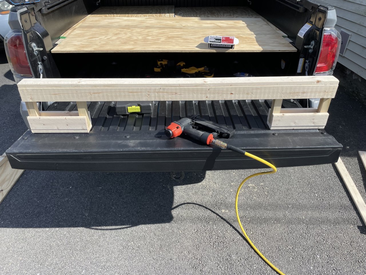

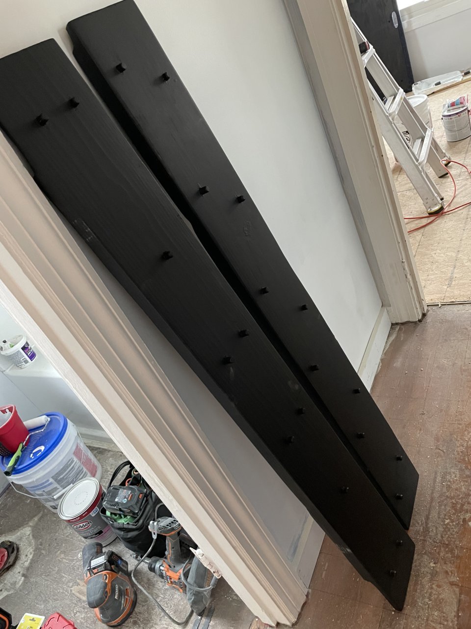

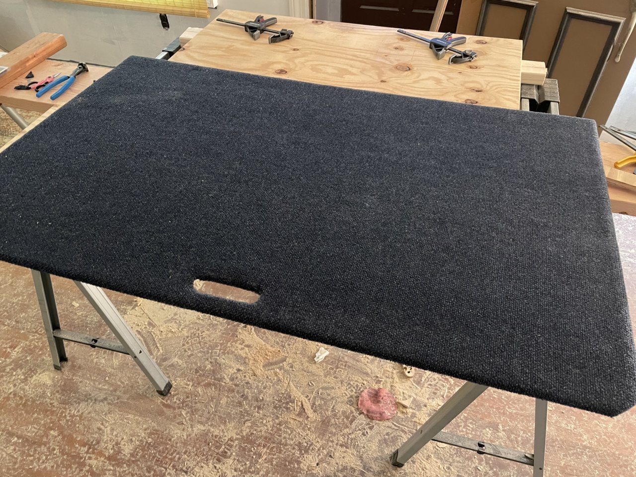

    Just finishing up my bed build i went with 2x8s notched out to fit the front and rear bed slots and they are shaved down to utilize the ledge around the bed for extra strength, and i used 1/2” birch plywood to make it light weight. I water sealed everything and now I’m just finishing up the plywood panels with outdoor carpet. It might be over engineered lol i also have a napier backroadz bed tent! Just trying to figure out what mattress or pad i want to use, air mattress is out of the question since i plan on taking my dog with me

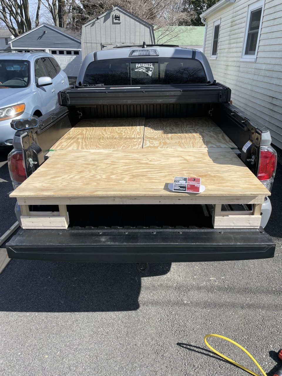

    Since i have a short bed i made an extension
