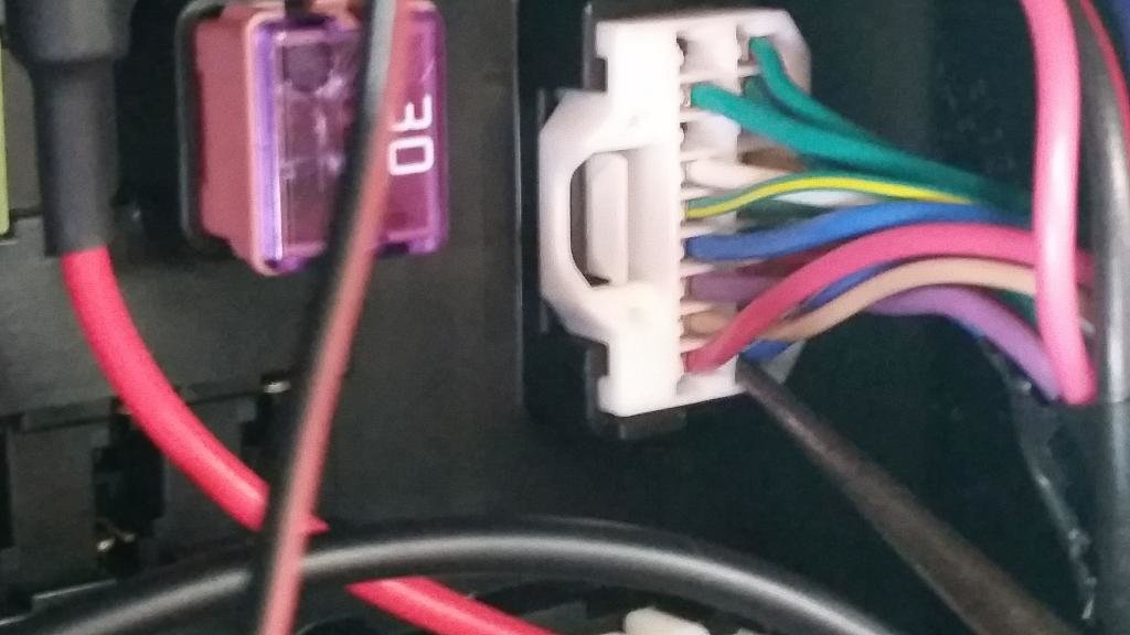

    All right, this is the best I can do for you...
    The left blinker on my 2014 Sport originates at the fuse panel, where I am pointing with the test light here. It is the bottom left, pink wire.
    The right blinker is the one right beside it, on the bottom right of this block. It is blue with white tracer.

    So, now I am confused... my off road has the pink and blue wires at the fuse box... so now what??? Is there an extra fuse that needs to be added???

    So, now here's the thing... I get 12 out of the pink wire and the white wire in that fuse box plug with the blinker on... so I need to figure out where that wire from the door stops and it may be easier to run new wire and tap into the pink and blue at the fuse

    Wait, when you put the left blinker on, you get flashing power off the pink wire, or constant power?

    PS: The white wire is constant power, nothing to do with the blinkers.

    I'm starting to wonder if you have power up to the mirrors, but not ground for some reason. It makes no sense to me that the power wire would be interrupted somewhere between the fuse panel and the connector on the door.
    Maybe take the left door panel off again and see if there is power at the pink wire with the blinker on. If so, then ground is your only issue.

    So I popped the pink wire out of the plug and put in a different pin that I had from an earlier project. When I run the pink wire to the mirror and the white from the mirror to a chassis ground I get the side mirror to blink. There is just no other way I can see around this so I will just run new wire into the email door
